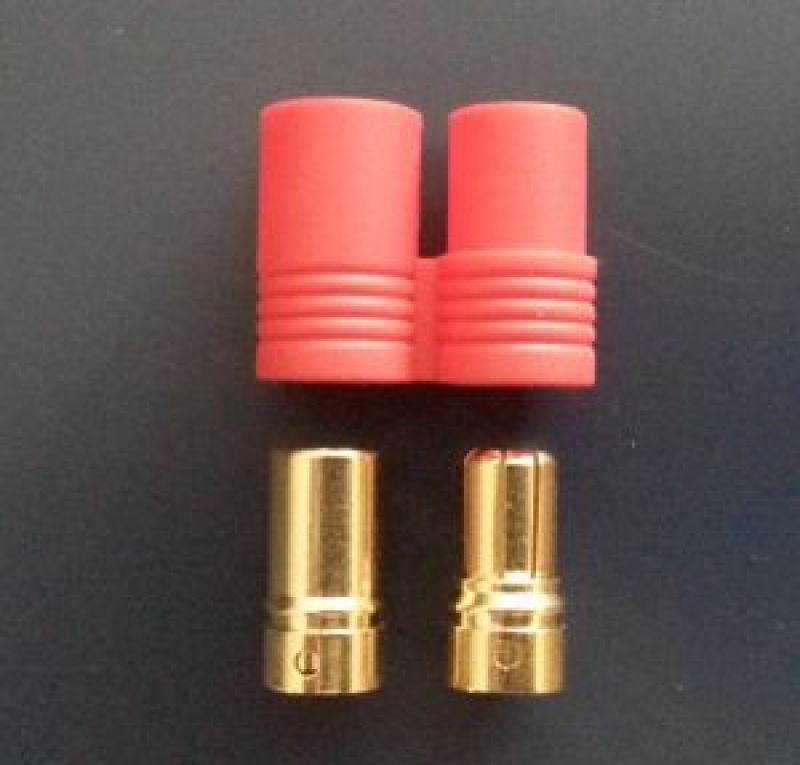

For the motor wires I use these:
The silicone grease also seals these perfectly. On the back of the plug on these however, you need to seal them or the water will penetrate into the contact side. To do that I solder, then Conformal coat, then seal with butyl rubber, and heat shrink over. Works like a charm!
