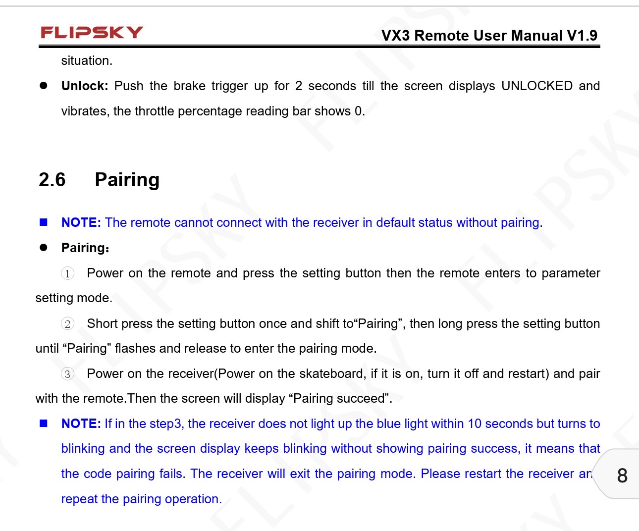

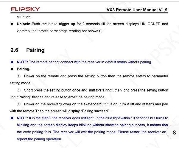

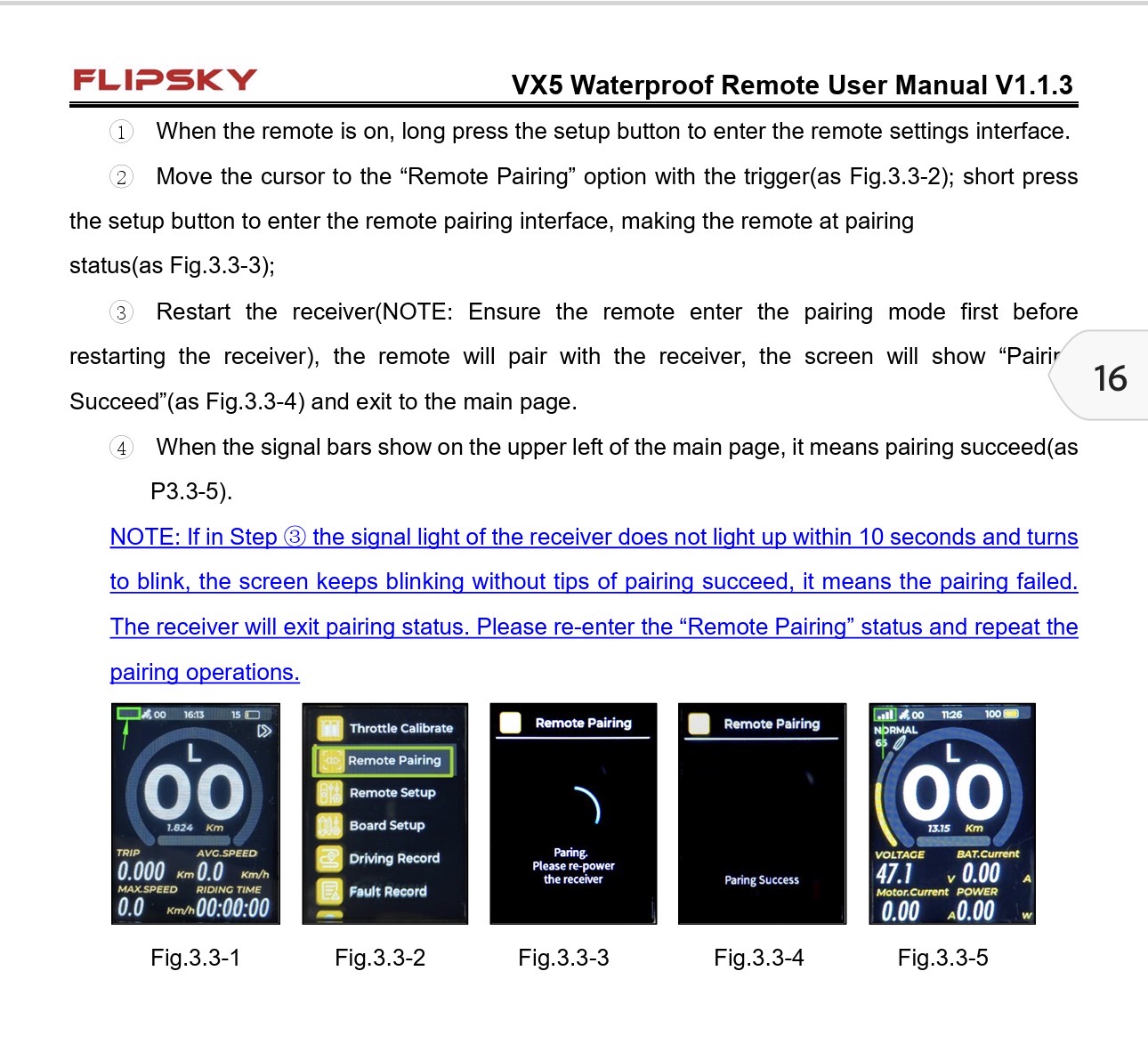

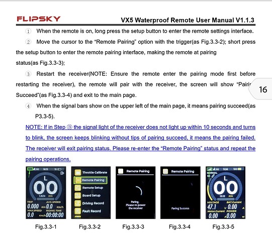

Binding the receiver with the remote is peanuts. Simply put remote in binidng mode, then power on device with the receiver, and it will automatically connect. So yes, you can use a single remote for 2 receivers, but you will have to pair them again each time, which takes 10 seconds.

Same with any other right? You turn on the remote, put it in pairing mode, put power on the receiver and the receiver will instantly connect to the remote that is in pairing mode.
