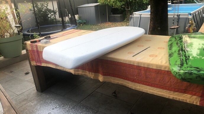

my new E-foil V7 project with 6384, Target full Efoil with wing / stab and battery with 2H battery LG M58T => 15kg

15kg efoil would be sweet! Following your build.
