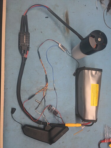

Got it all hooked up with the BEC, reed switch and everything, just need a Y connector now. It’ll be 12S1P 5000MAh. Wonder if I should go for 12S2P and a 10000 pack.

I’d do this. It also means the cells heat less and will have a longer lifespan
A 1p may not be enough if you are using cells. You will be putting out enough volts but depending on the 21700/1860 cell you are using, will decide how many amps you can put out. Are you using a lithium pack?? Then you might be ok. Make sure pack can put out at least 100 amps as if not it won’t power it enough or create a lot of heat and hurt the pack. If you are just going to use bursts of motor to get up out of water onto foil, then you might be ok with small lithium pack, not so much if you plan to efoil
For reference, here is the actual consumption with motor 6384 and 10s4p samsung 30Q:
FYI about batteries: the lower battery internal resistance, the better performance and the less heating. Therefore I would choose the leader Molicel P42A 21700. (There is newer version P45B, but it is still high in price).
I am using the flycolor 150A
