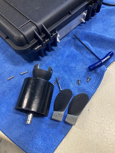

Foil drive is 6374 saute.
based on the @ELEVATE.rocks concept/idea. I’m progressing slowly but can open a complete build if that generate interest. I’m not inventing anything, just learning and growing.
I will of course paint the baseplate carefully. I decided to add threads and close some holes to make it neat.

Did you find out if they are spaced the same Tim? I am thinking about getting some aluminium props and a hub and it would be great to know for sure.

Just ordered the three blade. I will let you know if it fits.
Great. Thanks Tim. That is the route I want to take. If the two blade fits, the 3 blade will too.
