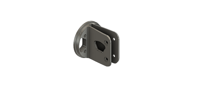

Some small updates my dad and I have planned.
  • New motor mount (Gong V2 <> 65161).
  • New all in one (Flite <> Gong V2 & VESC) mast plate.
