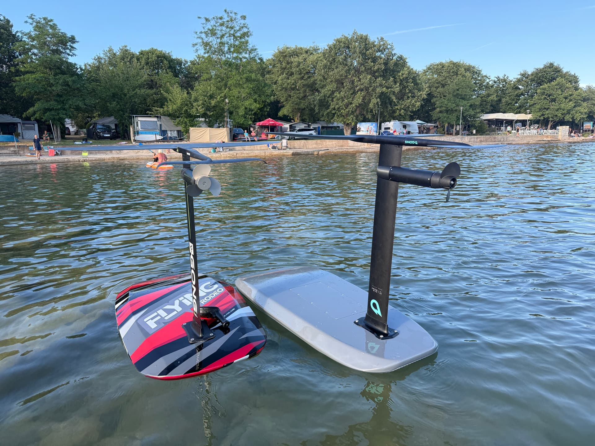

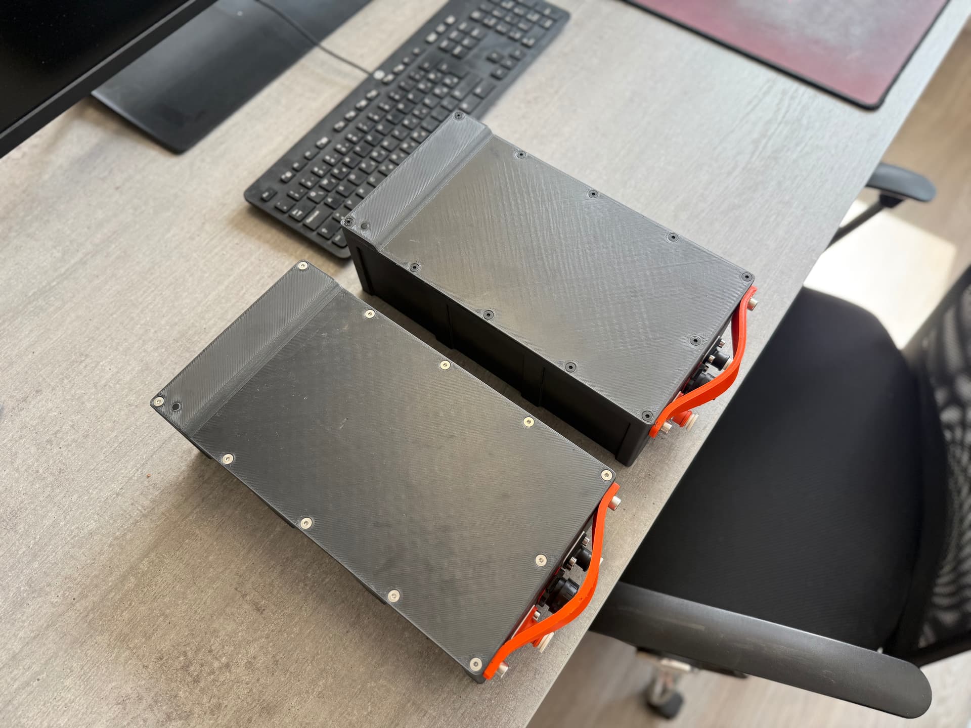

Second battery is done, this time I used P50B and I can tell there is no difference in 14s5p pack vs the 50S - except the price :open_mouth: Both provide around 50minutes of ride time.
Some pictures from the second board in process and over-weekend testings:
Whoah. You have the original flying rodeo board / mast. Cool! Don’t see those very often.

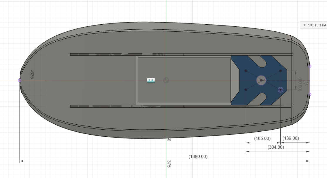

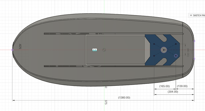

You are using Flipsky motor 65220 which is longer than 65161, did you reduced the distance of the mast from the the rear of the board to compensate?
What is your distance and are you noticing an extra lift effect due to the additionnal length?
Many thanks
I did not really think about that, I just copied the Flite ultra dimensions and ratios and thats it.
I did cut into the mast more than “normally” to compensate the length of the motor.

Nice work! Would you share your CAD files of the mast? How deep did you cut into it?

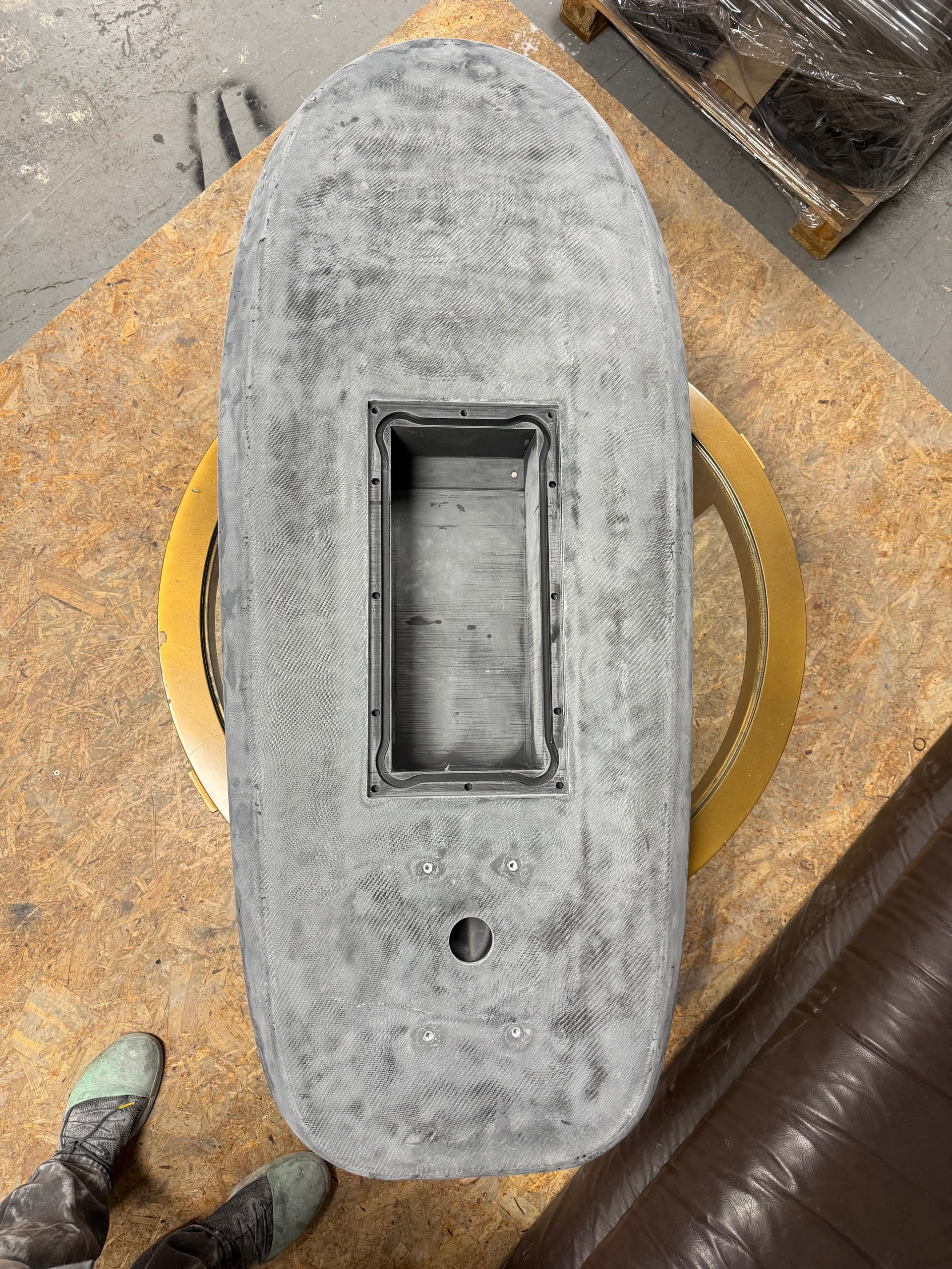

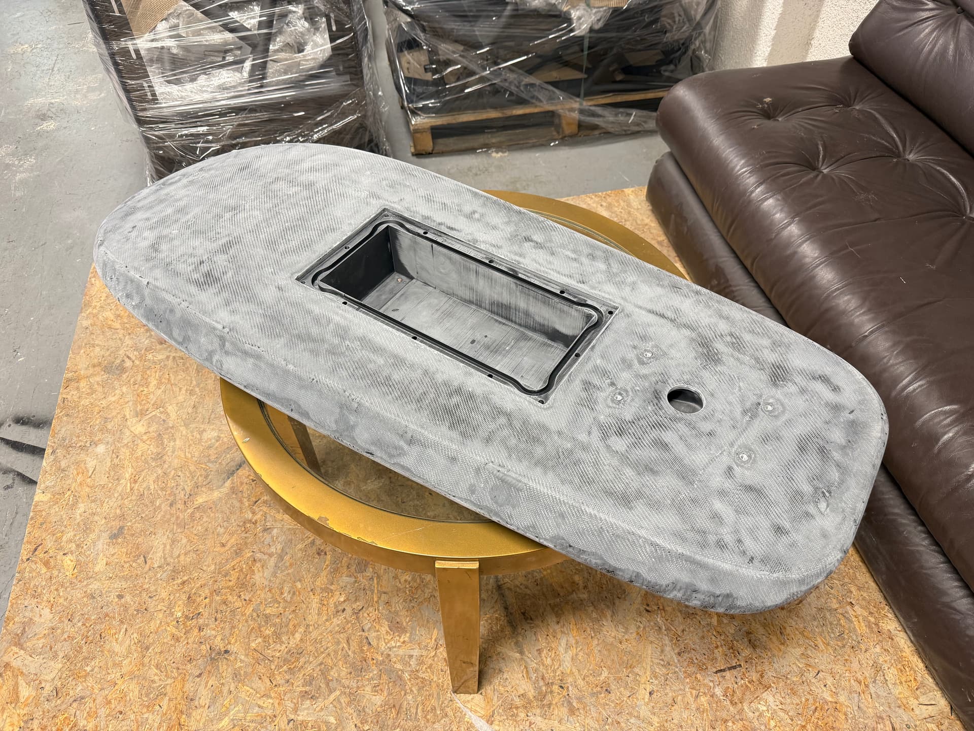

I am looking at building my second board and wanted to take a similar approach to sealing the main board hatch.
What approaches to sealing did you try? I am looking at a flat EPDM foam gasket, but can see you are using O-ring cord.
What size did you use? Does it perfectly seal or do you get some water leaks?
Hello,
here you will be able to find all the files to make one yourself, including motor mounts, cone, end cap, mast adapter plate etc…Fits 65161 as well.
Regarding the sealing of the mast adapter plate, simple aliexpress o-ring, no leakage.
Regarding the main battery waterproofing I glued together a 10mm x 10mm rubbery like material that i bought at the local hardware store. It has closed pores. No leakage whatsoever, a bit comes in when opening the hatch. The pressure from 12 screws is sufficient :slight_smile:
