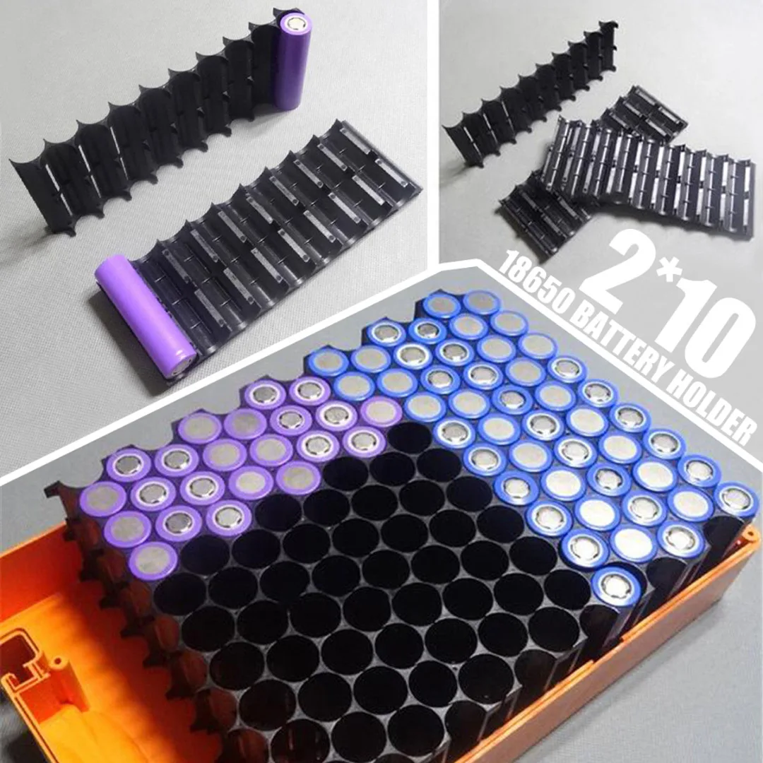

I looked at this kind of supports for 18650 but no delivery to France…
So I’m looking for…
I think you are looking for this kind of support for a offset configuration
Nickel strip may be hard to find since most of the time everyone glue the cells …
I wanted to keep a small space between each cell for air circulation and help with heat dissipation…
Cut the holder, keep 10mm on top and bottom , and glue it to the cell

Did you buy it or print it ? If printed, would you have a link ? Nice project.
Indeed I printed it in PETG, currently I am not at home and go home on the 28th,
I will share the link after that date.
HERE the link for the HOLDER 12S12P:
https://www.thingiverse.com/thing:3987091
