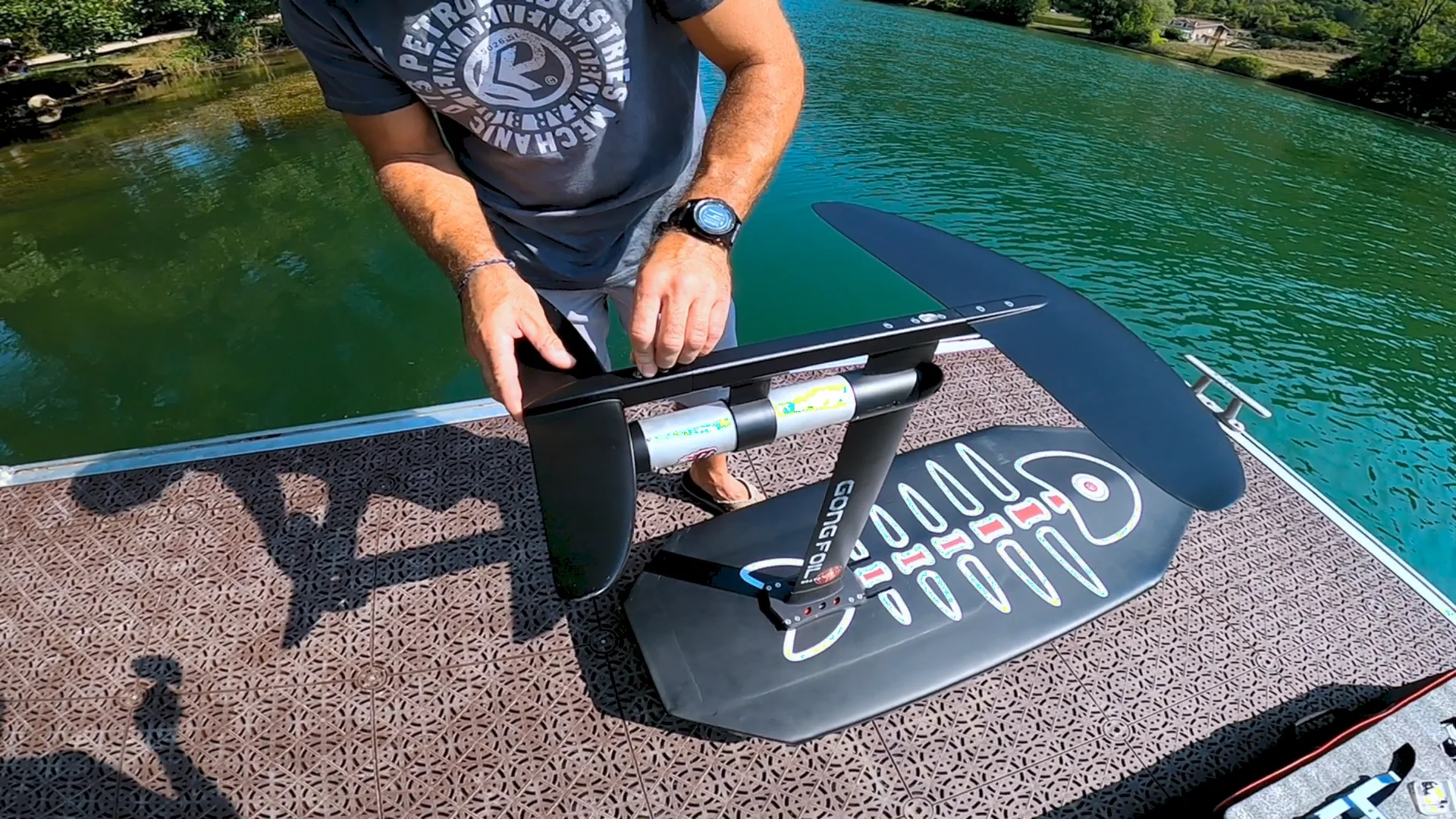

Hello @Makermike What connectors are you talking about? And actually concerning the battery it’s one that I made myself.
And hello @JJREBELO about the hatch I bought it at RUE DE LA MER here:
https://www.ruedelamer.com/trappe-d-acces-top-line.html
Note that I doubled the existing seal for a watertight hatch and that this one is glued on the deck of the board with Sika i291.

Can you please clarify if you can stand on this hatch? Does it can support the height an Adult person? (~80kg)?
is it completey safe to use? Or did you make any additional mofification ?
Best Regards,
João Rebelo
on the sales site it is written that you can walk on it, and the only modification made was to double the existing joint .
