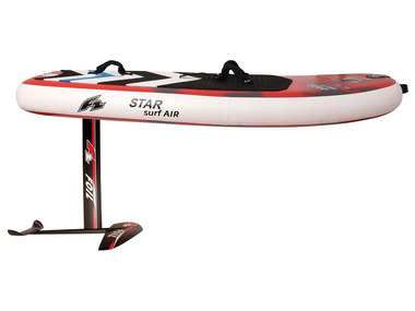

or you buy a F2 inflatable SUP foil from Lidl in Germany for only 699€ complete with foil.
Add flipsky motor +Remotecontrol and Trampa ESC, put in ESC Mast Box of e-foil@elevate.rocks add a battery that you put on top in waterproof case and you get a DIY efoil for only 2500€
Do you have experience with this setup? Are you from Germany?
Do you have information about the box from Elevate.rocks?
Not really a Sup Foil (3 footstraps), not even on the F2 website but an interesting price…
F2 Kitefoil
unbeatable price… :sweat_smile:
Has anyone tried these? I’d be excited to experiment with one if I got some positive feedback before splashing out 800 euro…
Looks like Lidl is selling them.
However not for that price.
https://www.lidl-shop.nl/p/f2-opblaasbaar-foil-sup-board/p800000320
The German shop sells it for 1099,-
