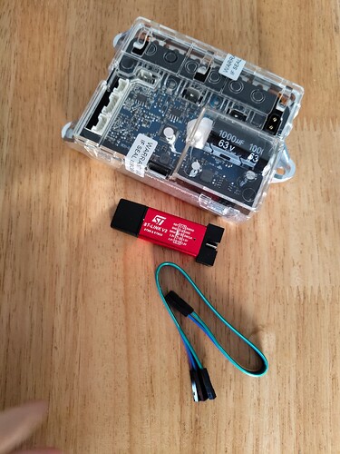

Also received this as part as my “cheap as a challenge” arc :joy:
There is a reflash GitHub where guys ported vesc tool on those.
The xt30 will have to go, but rest of the HW should take good amps and is well cooled with the cast heatsink.
10-20€ cost per controller, due to the fact it’s a mass market product.
What controller is it? Do you have link?
M365 v3 controller (Xiaomi)
The GitHub project I have to find the link.
There is only uart control possible, but with our use case and uart Rx, it should work without many limitations.
The board can only read up to 103A phase. The FETs do not have thermal paste or pad by default, I will add one.
There is a thermal sensor on the MOSFET.
The board itself is tiny, but the heatsink and plastic cover is massive.
I will update when I get it flashed/tested.
The mos are not great, to220 and 4.1mohm rdson.
For reference, mks84100hp has 1.2mohm and Tol-8 package
The scooter is max 600w, can you reliably run a foildrive off this esc? Seems like a stretch, how many mosfets?
Plan is Full reflash of the STM32 on the board, with vesc tool support.
That unlocks the full potential of the board, outside of base fw limits.
Hope to run 50A batt and 80-90A phase, for 10 seconds needed for a start.
It is definitely possible on a 6 FET TO-220, but only with good control, good FETs and good cooling.
600w is not enough, for me 1000-1250w is the bare minimum IMO.
Control is unknown until I can see the current measurements curves, FETs are not great but easy to change if needed, cooling is easy to fix when other things are tested.
Better matching of the prop will enable to reduce the phase amps and get the needed power out without overload of the phases.
Here is the GitHub, if you look into the linked Google docs, there are divider/ADC values and max hw measurements values.
Ok, it seems so small but 6 fets could do it. I’ve run up to 300A on 6 fets.
6 FETs is the minimum for a vesc, with TO220 the max current is also limited by the package.
Could work up to 100A for a short time if you change FETs to a lower RDSon type. What could be a problem is this point under cons:
“for now, it needs hall sensors (no sensorless mode). [work in progress]”
Outrunners run wet normally do not have hall sensors, hopefully sensorless was implemented in the mean time.
What does that? 20char
Good catch, have to check that!
Prop matching enable to have to motor operating close to max efficiency/rpm range.
