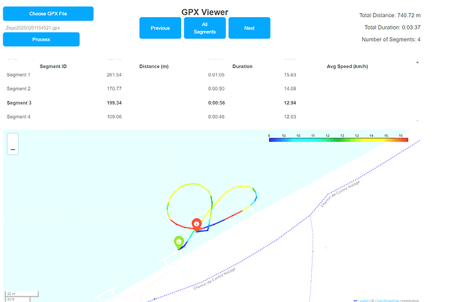

did not record the full session, but here is a view of my updated GPX tool, available packaged as an EXE now. Deepseek went 1 step further than Chatgpt in the implementation, now in a web browser with python backend :wink:
With light pump board and 1201, I had good feelings and easy pumping.

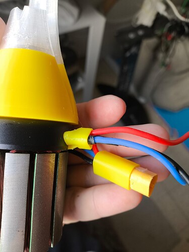

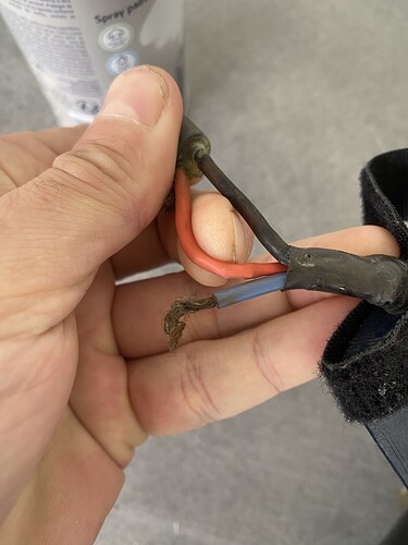

Need to do some maintenance, water/saltwater has eaten my phase wires.
Pumping the dw board before the calbles failed
For added protection of the soldered phase wires inside the motor, I will fill the 6384 base with epoxy and route the wires through a PETG guide into the MT60 connector.

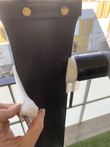

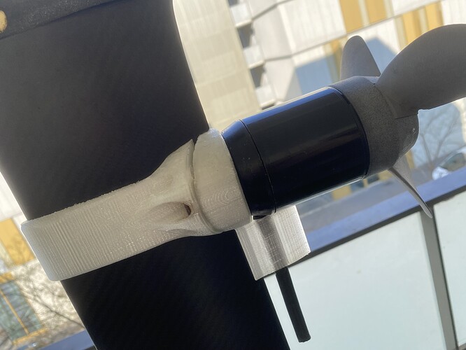

Here is how things are looking with the flex mount as we discussed with @lishine
I did not adapt the length and as a result it does not fit the wide top part of my mast.
It has only one m6 Blot to take it off. Seems strong enough.
I will see if possible to stretch it or If I need to reprint.
Tried to stretch with hot water, and heat gun without success. At least I know it is strong!!
Modified to fit upside down flange nut, with room behind the nut for the bolt tightening.
Modified the length for fit my mast thick part (+20mm)
Modified the 4x m4 bolts pockets to fit 12mm screws I have in stock
Will re-print according to this new file (14h / 170gr print)
Great that it is strong… I hope that one bolt for tightening is good enough. If you try to rock motor up and down, you may see edges lifted.
The other side is fully attached, yes, in case when motor bolts coming from the outside it is possible.
Question is maybe somebody can calculate the impact on drag of these holes… How much more drag in percentage relative to motor or relative to motor+mast. Hard to compare because mast and motor assume gradual surface drag, where the bolts in the holes are blunt flat…
What I learned is that tpu is pretty beneficial anyway for not transferring vibrating, at least to the surrounding plastic shell or to the rest of the system.
I will probably fill the 4x M4 bolts with hot glue, so only the M6 hole remains.
My goal with this system is not efoiling, I will be on motor only for a few seconds at each start, i’m really not worried about it.
