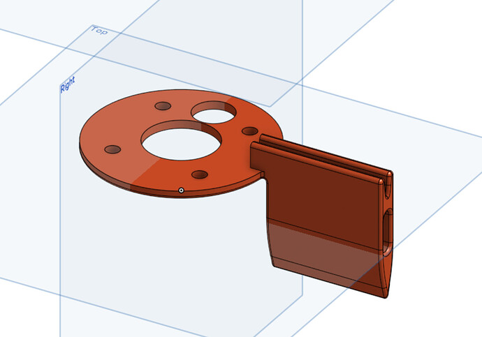

Ok, let’s assume that the drag is negglible.
Then I will wait to hear is there any wobbling there when rocking the motor up and down. If there any wobbling, two motor screws could be made longer and hold the pieces together instead of the M6…
What were your considerations when you made that diagonal cut between the parts, instead of flat?
The flange nut reminded me to mention my experience that m4 bolt and m4 nut under hefty tightening sink into the tpu, so I used washers. Flange nut is a great idea!

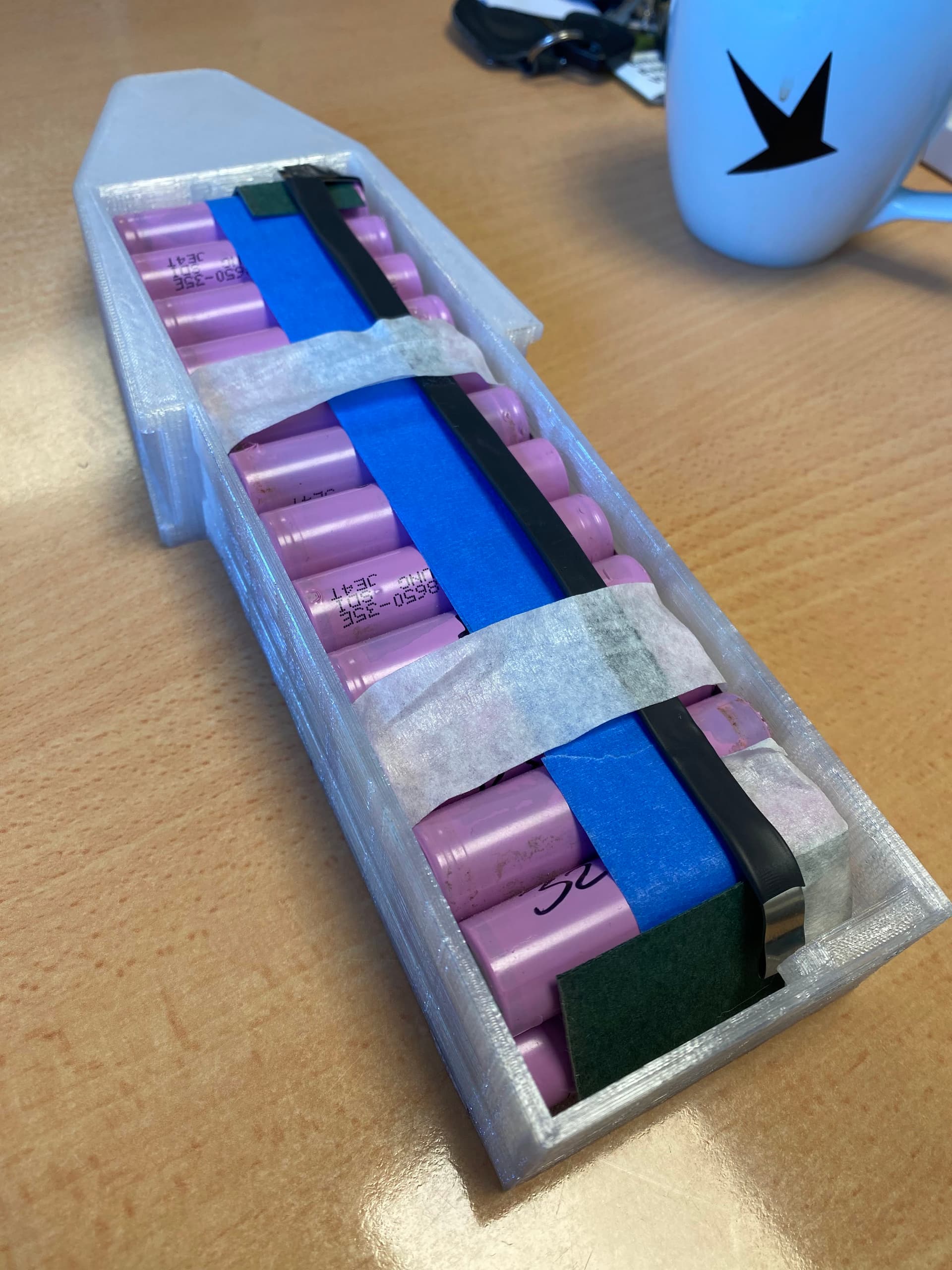

Now on my 4th battery build for this setup, this time with salvage 35E that were all capacity tested OK.
Hope it keeps balance better than the other 30Q packs
15+ hours print at 100% infill and 3mm3/s max flow rate for tpu
The holes could also be filled and shaped to match the contour of the shell with moldable EVA foam. This foam can easily and non-destructively be pulled out to access the bolt. Then pack and shape a new foam insert when reinstalling again.
Print was a failure after 8 hours of print, trying another method now in two parts and integrating a cutaway piece to act as support.
Edit, changed again to ease printing
I had lots of print failures trying to get this flex mount to work, but not giving up yet.
Finished and potted the 35E pack.
That is such a compact and smart looking battery build. Perfect form for what is needed.
What are you using for potting?
Epoxy/casting epoxy
Works well for me, but probably not great for bigger batteries
I wonder if balance issue you experienced could be the casting expoxy eliminates room for mechanical expansion of the cells and/or may be thermally too insulative.
Probably the 30q samsung cells. They continuously die on the lift batteries just like that.
@gazlinux I don’t think so, I agree with @Jezza , something very wrong with 30Q cells, they are not stable at all. I used 20K of them for batteries we built at work, and despite good bms and cell matching they develop self discharge when they heat up.
My experience with 35E is the complete opposite, very stable cells.
The 35E pack I made clearly has less power, but I still managed to start without any issues on my 4"2 board. will be more challenging the choppy water and low battery. With the 7"2 board, it should not be an issue.
Did not push it as I forgot the TPU and did not want to risk loosing the whole pod and prop!
