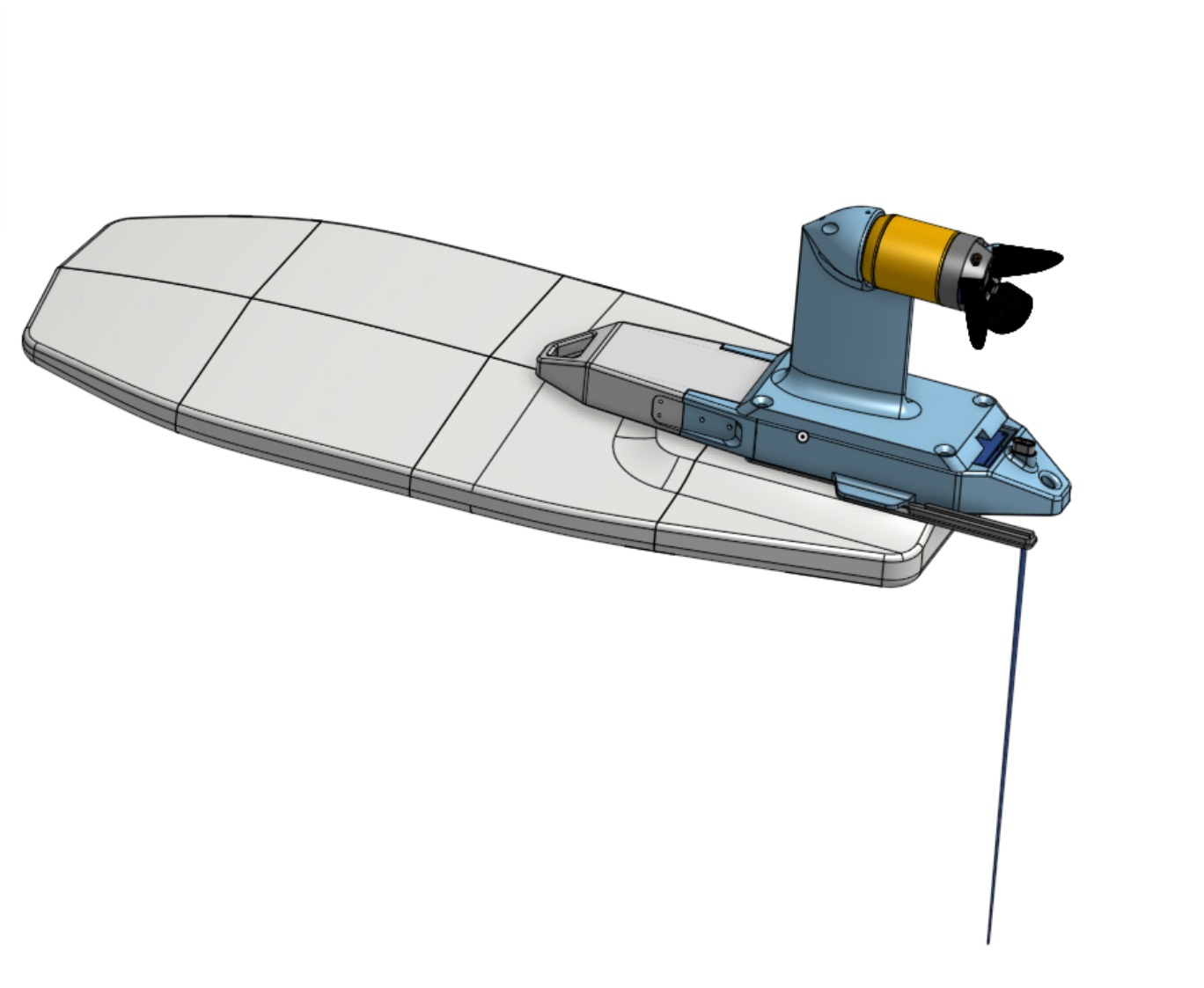

Here is the current state of the system, with both batteries and the balance board.
The latch got very rusty, not good stainless steel, and I dont even ride in salt water most of the time.
I did not solve the pod situation yet to design and produce a really Quick release pod.
Files are now mostly sorted and available for anyone to replicate, just PM me if you want the link.
Updated the onshape doc with build infos and pictures. What is missing is the materials and print parameters (infill/walls)

Instead of the metal hatches, should be possible to connect battery and housing using the same principle and universal strap as the nano pod uses, one on each side, especially if combined with mechanical design to lock it in place first, offloading the strap from doing the static fixation?

Looks really nice. For fun I added a 3D printed latch to your model where the latch can easily be replaced if it breaks. I’ll let you know how it works.

First test was not a success, but everything works, including the signal wich is very good with the extension antenna, without direct connexion to the main antenna.
At around 30% throttle, the “boat” start to rotate and the prop comes out of the water. Probably needs a bigger board/boogie.
Maybe make some outriggers.
Hi Adam! far too much weight at rear of board ??? You always try some crazy experience :upside_down_face: ! thanks for sharing !
Needs to be wide and flat at the back…stops the twist and roll you get from a thin transom/backend
Also…movebrhe engine.much farther forward. Does thia board have tracks??..if it does…use it with an ali.mast and engine pod…gives you a ton of trimming options. To far back and the nose will rise…more.towatds the middle and the board will flatten out…trimming.is also.a.function of weight distribution (battery box) and motor position.
