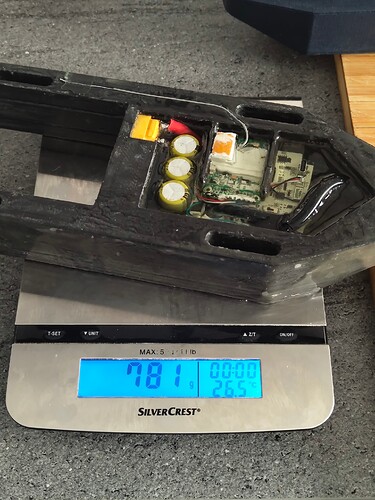

Controller casting 780gr
Battery casting 1550gr
Total assist weight 3620 gr with 6384
Previous version with double the battery capacity was 4280gr + board mount. So in total saved 800gr approx for 240wh less. (260 now vs 504 then)
With board 6370gr = the weight of a good DW board (gong cruzader close to 8kg for exemple)
