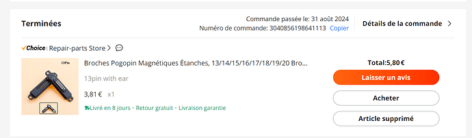

Here, I received the actual ordered connectors from both stores…
So at least your know now that they are real ![]()
Ordered again from the first store, we will see, I chose the model “with ears” so the sent me ear nut ![]()
