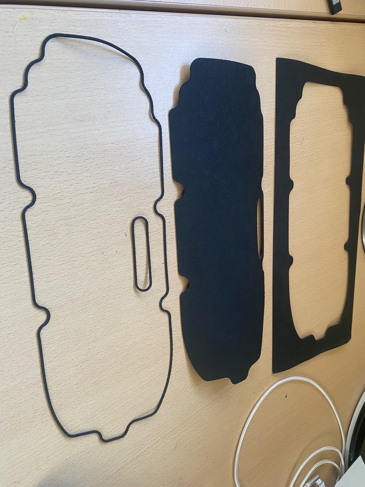

I am trying to cut gaskets from Flexoid paper using the knife tool for the Bambu H2S seems promising, just need to get the thickness of the paper dialed in as the .25mm i tried is not compressing enough.
I had good sucess with eva foam (hobby store stuff) both for assist parts and cooling circuit of my 2 stroke boat motor. It handles significant thickness compression.
At work, I use custom cut foamet seals, aluminum 0.4mm + 2 layers of neoprene (nbr) foam. Good stuff.

I have some eva on the way for more gasket experiments

EVA Worked out well thanks for the info.
