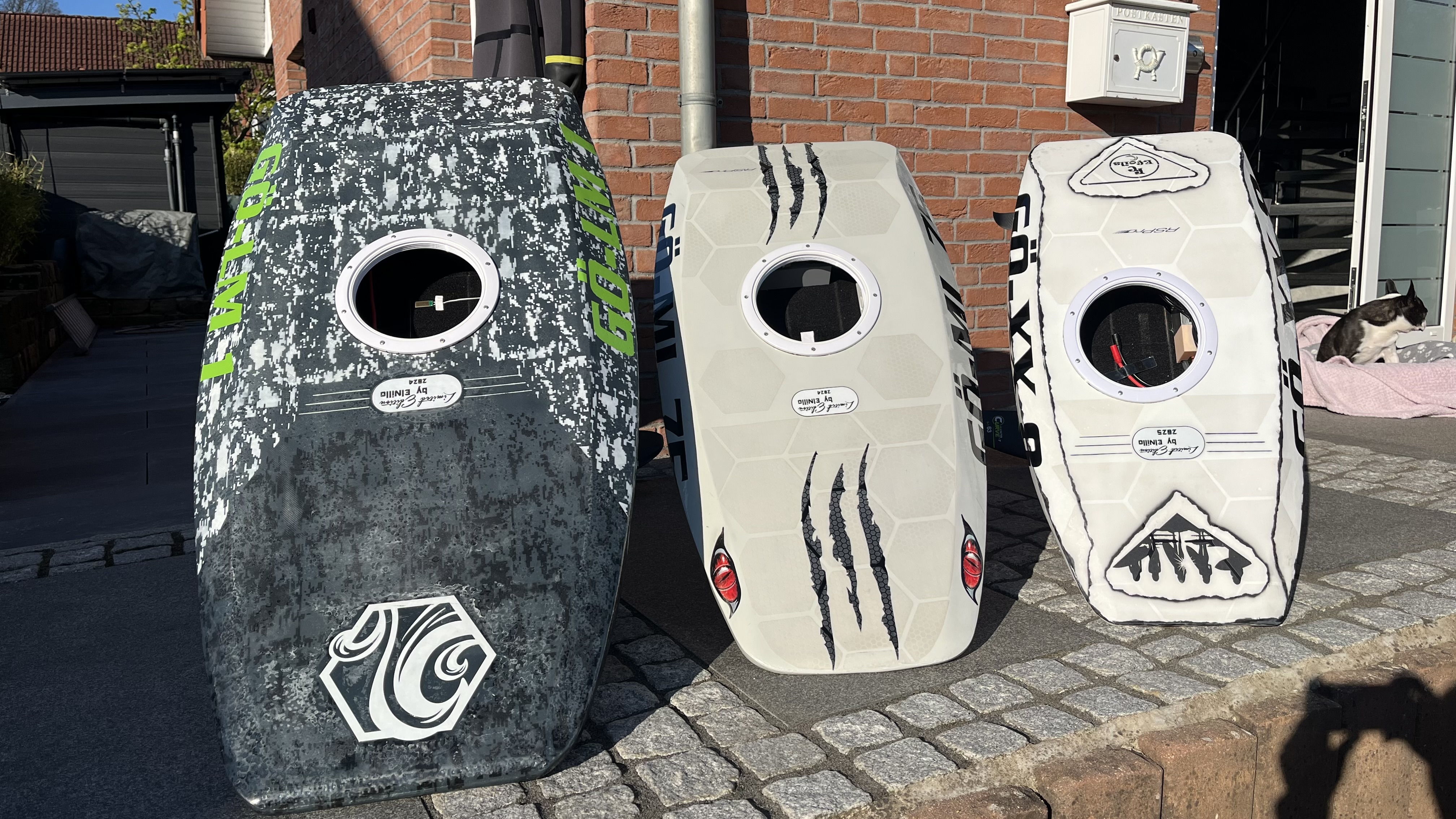

Board got a bigger sister for beginner foilers like my wife: 145x70x12cm, 86liters vs 120x60x12cm, 61 liters

awesome builds! what hatch are you using?
Thank You!
It‘s the Osculati round inspection hatch. Size I think is 230mm. It‘s the biggest one.

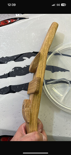

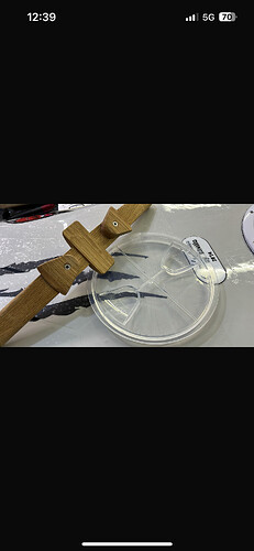

It‘s 100% watertight. For opening after foiling you Need a Special tool as a lever
What kind of tool? Can you 3d print it?
Yes, I have 1 3D printed and one made out of wood
Would you mind sharing the 3d printed tool to open it?
Next time on the PC I can Upload to Thingiverse.
But I prefere the wooden one.
Osculati Hatch by elnillo - Thingiverse
It was qick´n´dirty, not nice, but is woking.
You have to screw it on a wooden stick for example to have a longer lever
