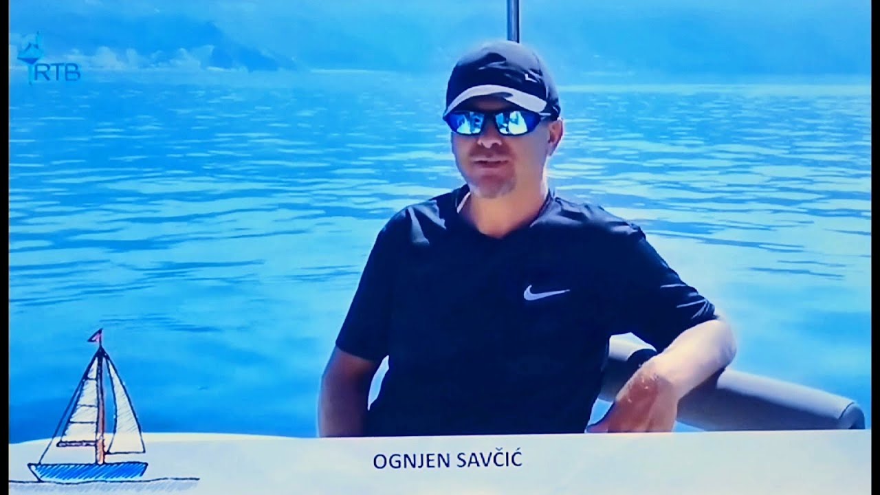

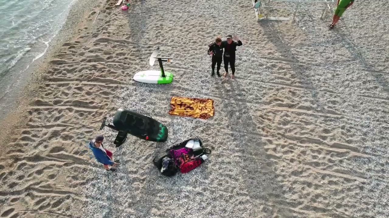

Some shoots with drone on local TV with my V2. Explaining what is efoil… Sorry because is not on English but interesting video😀
