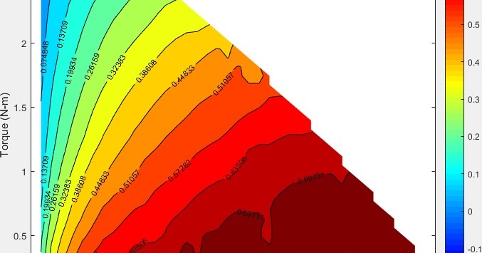

Since you have both motors, what would you estimate the efficiency of the FR motor is compared to Maytech?
I sure can help with this question. Chinese motors won’t have a better efficiency than ± 70% or a bit more. They are using cheap products and cheap lamination steel. The rotor itself is not even laminated, resulting in lower efficiency.
FR motor should be higher than 85%, my guess, hard to tell without testing it.
More info here if anyone interested to see real results. Not mine though. Someone working at MIT lab :
