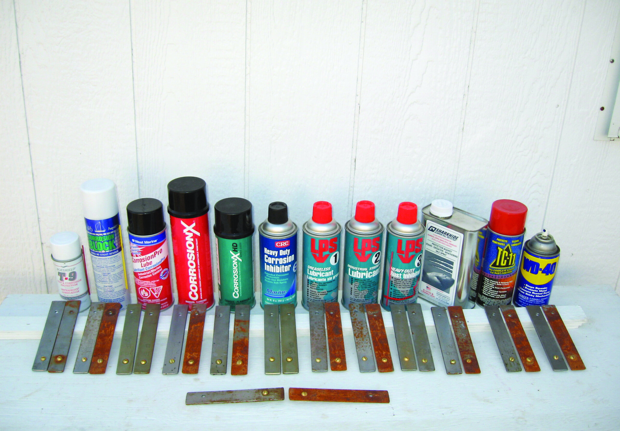

I think the focus on corrosion x is not really correct. It’s not even in the top three in this test:
Surpassed by four other products in this test:
http://www.home-machine-shop.com/Rust-Off.htm
There are other options out there and some of them seem to work better, probably cheaper as well as corrosion x has quite a hefty price tag
