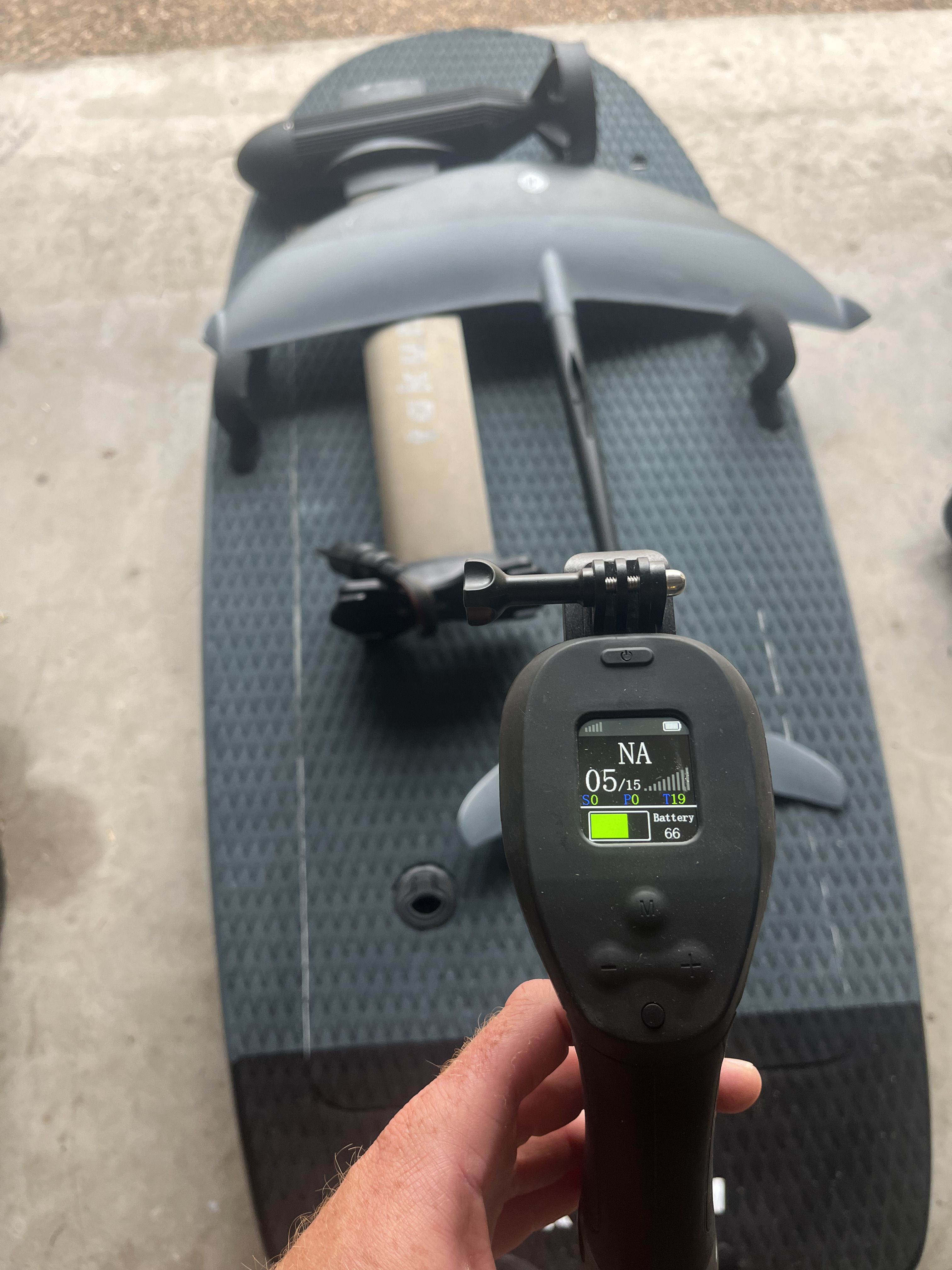

I recently picked up a 2021 Takuma carver from marketplace for cheap but it didn’t come with a battery or original remote. The remote that came with it is a Pulseer remote that won’t pair with the board.
Is there any way to use the Pulseer remote without buying a Pulseer E-Box? The E-Box is around $1,900, and I’m trying to get the board running as cheaply as possible.
