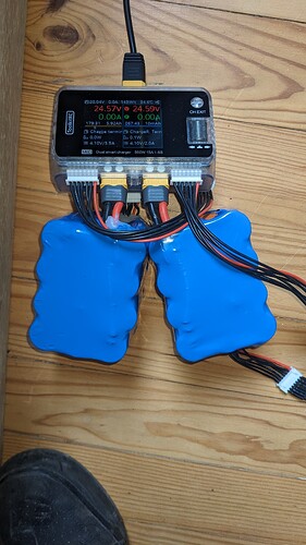

Do you use a balance charger for your 10s3p battery? If so, can I ask which model you use? My current balance charger goes up to 8s and I’m keen to try a 10s in the future.
Thanks.
Yes. Junsi iCharger X12
Cool charger!
Can you post a wiring diagram of how things are connected? The balance wires make sense to me but the red and black combos don’t.
Just zoom in and you will see :grinning:
OK thanks he says sheepishly!! :clown_face:
Still curious about the fixture on the top of the pack though.
Check out the pictures of my battery build in my Build Topic. It is a handle so that I can get the battery out of the box or lipobag more easily.
There is also a spacer in the box to the lid so that the battery does not move around in the box.

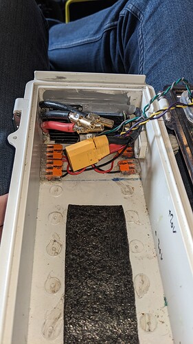

Hi @Etiennebzh , your build is awesome, I’m doing a similar build, two questions :
  • did you test the HV3 80 A ? (are you sure it will overheat with 10 min efoiling for example)
  • how do you fit 12S2P in your box, with the ESC on the small side of the box ? (I’m doing 10S3P and it s really a tight fit, with ESC on the long side of the box)
Thanks,
I had the cheap Flydragon 80amp esc but impossible to keep it cold with 8S and poor settings options. I didn’t try with 12S and I didn’t try the X Cross 80amp.
The X cross 160amp fits perfectly in the camdenboss box by it’s width so for the difference of price I recommend the 160 No doubt. Blheli is very good for programming. I lowered the current protection to 50 amp lately and it works like a charm.
Thanks for your quick answer, very clear with the photo.
