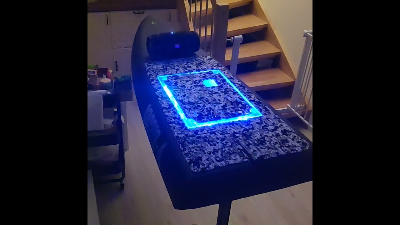

Working. Little water intake, need to be fixed. Should be not a big deal. This board has my original 65cm mast, I am used to the 80 one now. It’s so different. I put the FR prop on the 100kv, this is so slow
next time printed one
He is back. With all these (semi) professional builds lately I feel kind of ashamed to continue this thread
Anyway, I have upgraded to passive water cooling which worked really well. I had to adapt the mast clamp (front only) and drill another hole in the mast side.
I use the mast directly, there is no tube inside
Due to the loss of the pump I could tidy up my interior a little bit with a self print box. Also I moved to maytech remote (epoxy treatment). I like the feature to turn on the led by relais
Furthermore, I have add the gong foil curve MT to my collection. I really have to test a lot for the next time, especially the flite prop (adapted already)caught my interest
