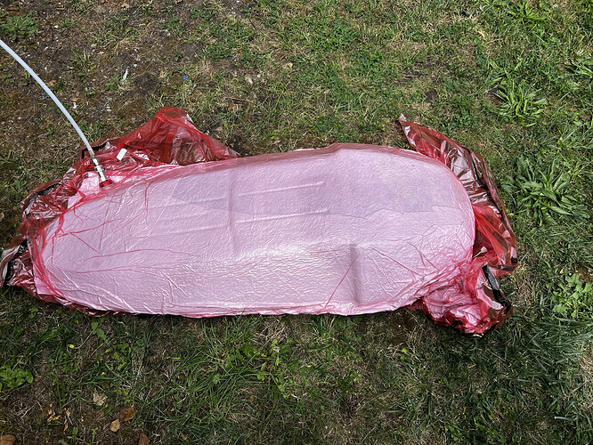

I’ve added some foam sheets to level the USBOX in the front
and then smoothed it…
Added one carbon sheet and GF under vacuum.
I’ve also decided to make a bigger central area to enable the cables to pass easily, so I created a box with 5mm airex sheet that I’ve reinforced with CF
I’ve then cut with a seesaw a good space in the middle
It’s super smooth and fits very well. I’ve also added some epoxy + glass cells to thicken the epoxy.

moving on and it’s almost a wrap. I have additional ideas (including a more polished surface smoothing) that I could implement but this will come in the next iteration. Let’s see how this new version operates on water.
Going to do a different visual and some crystal look with a red candy color.
the USBOX upgrade has proven to be useless. for some lucky reasons, I got the right balance since the beginning. I’m going now to add a bigger lever effect and reducing the boogie clamp size. I may also try a (5 to 10cm) deeper mast but not sure about the ultimate value.
still fine-tuning but overall it works as a charm. doing it for the glory of science !
