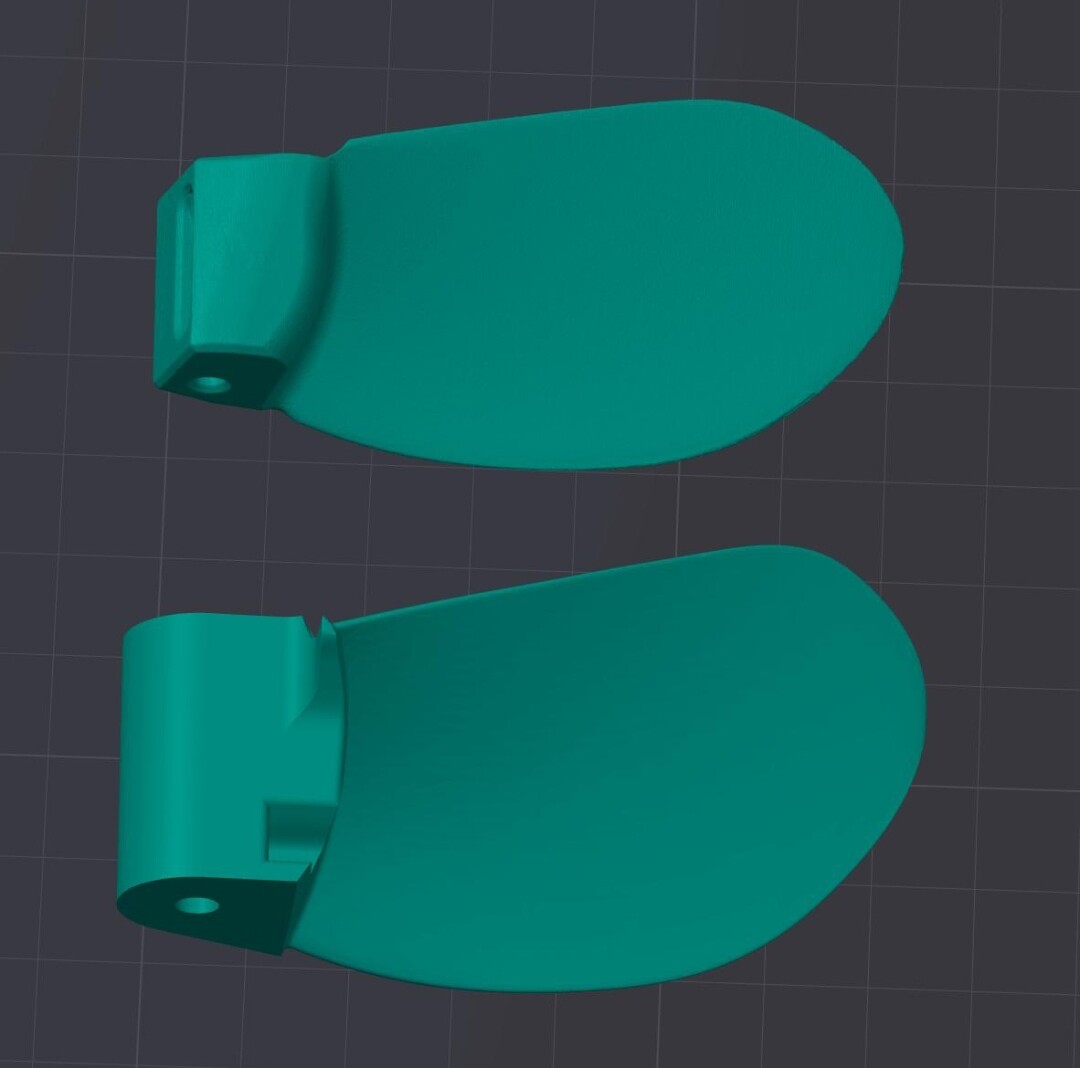

Hey everyone,
I used 3d Scan of a propeller inspired by the Flite Prop and adapted it for use with a standard threaded shaft, such as the Flipsky 65161 motor.
I’m not sure about the legal stuff of sharing a Flite style propeller - could this be an issue? I want to avoid getting in trouble.
If you’re interested, let me know!
Best wishes from Hamburg,
Tolga
You say you designed it? Looks like the 3d scan someone provided on the forum and then made the appropriate mods for the mounting.
No, it’s just an adaption for the threated Shaft, but it works great. I really liked the propeller and found it a shame that there wasn’t an adaptation, yet.
Here we go:
https://makerworld.com/de/models/1180328-flipsky-e-foil-propeller-for-threated-shafts#profileId-1190362
have only digitally copied, don’t have axis to a 5 axis machine, was wondering if anyone would print in glass filled sls, see how they hold up

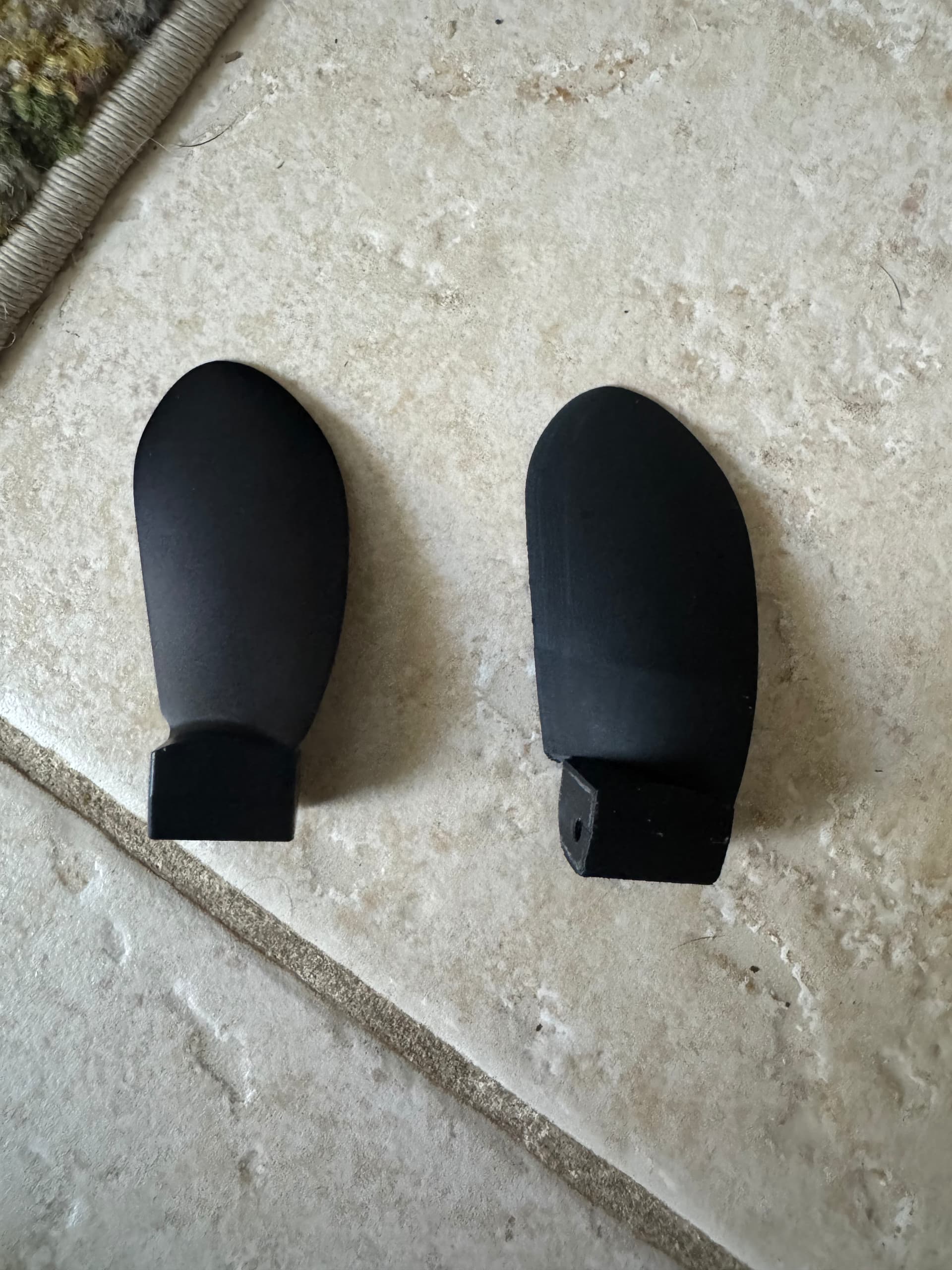

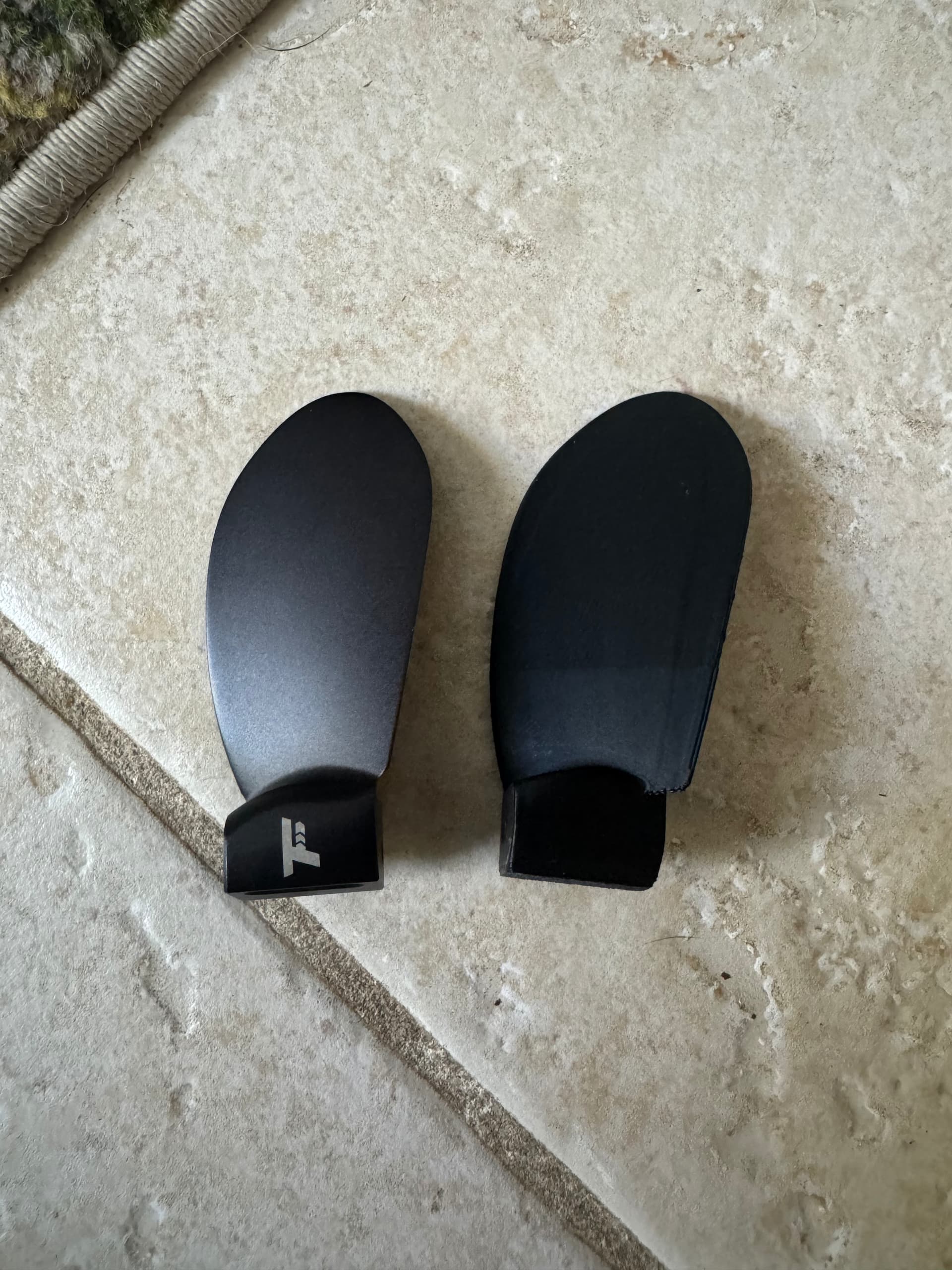

I’ve also scanned the FD prop but haven’t shared it yet. I had one printed in aluminum via Craftcloud, though I haven’t tested it yet. Initial impressions suggest the FD prop is significantly weaker.
I also received a standard prop printed in SLS nylon with glass fiber—see the picture. I’m unsure whether a prop as thin as the FD one would be strong enough when printed in plastic…
At $10 per aluminum blade, what is the point to use nylon?
BTW the regular prop is $20 per blade, because it is bigger. Then nylon-gf makes sense

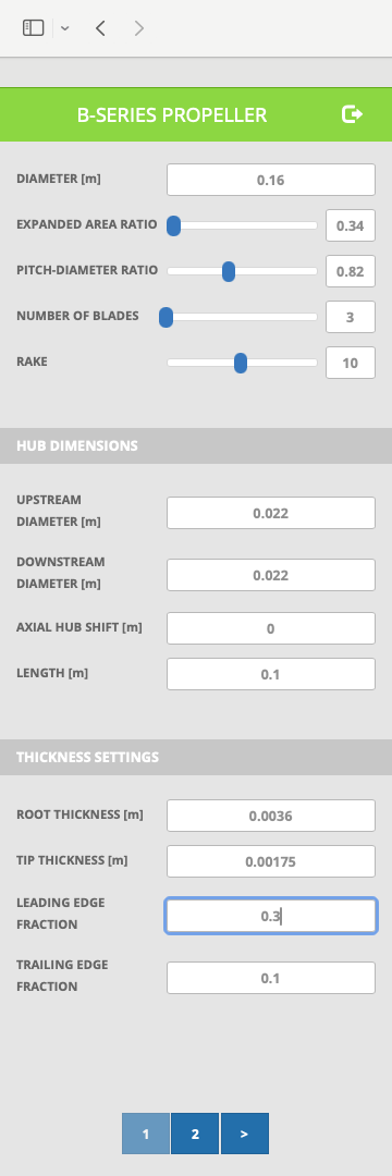

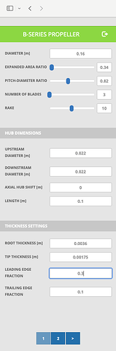

so I tried scanning it with my iPhone, and obviously that didn’t work, went on to the propeller generator site and played around with the settings for an evening, printed about 20 propellers till I got it right, the base I just made and added in fusion together. currently don’t need propellers but I just went on craft cloud and saw the pricing for multiple and that is indeed a deal, previously I was just looking at a qty of 1 and figured it wasn’t worth it
would be interested to know if I got it right compared to yours, either way I figured its an actual propeller generated and not scanned with ill information, I wish I had a 20k laser scanner :crazy_face:

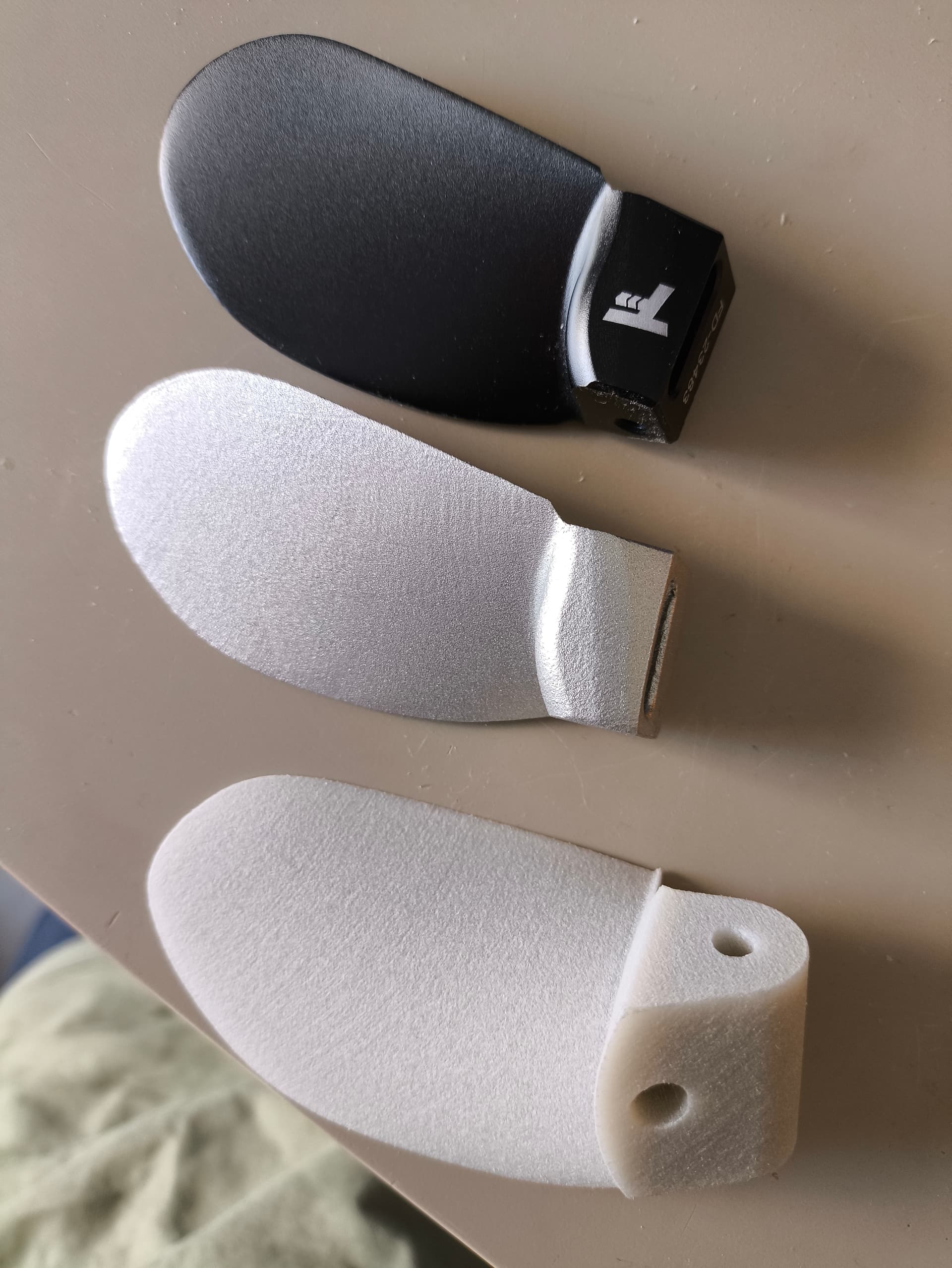

I 3d printed aluminum FD like prop.
According to Craftcloud, @leachim blade dimensions = 75.01 × 39.93 × 37.24 mm
What are the dimensions of the FD like one ?
When do you think you could compare both props in the water, startup and Wh/km ?
Size different and pitch is different.
The characteristics of various props are under investigation.
So far I can tell that regular prop operates at 2800rpm, demands more current and provides more power.
Flipsky aluminum prop operates at 3800 and requires less current.
FD 2 blade operates at 3600, requires less current, but provides less power.
6384 Ali 120kv motor.
Intending to test lower kv when I get such motors and 3 blades fd.
