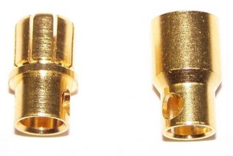

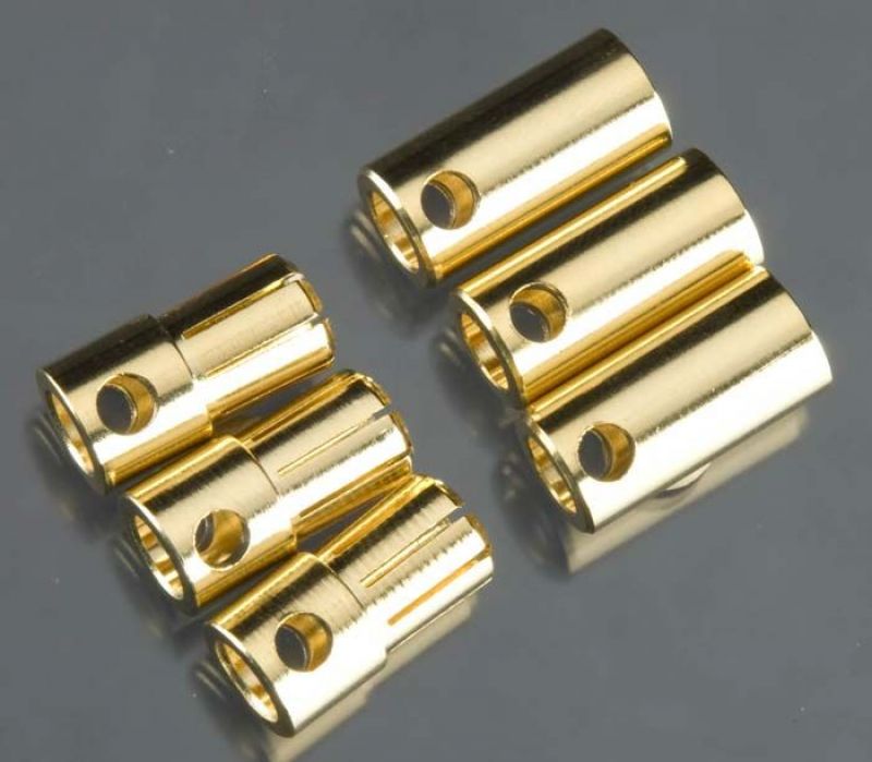

Regarding the Cnlinko connectors:
If I remember right, you said that long 8mm bullet connectors work better then shorter ones?
Do you have specific ones that work, maybe a link too?
I found these ones so far
I think both connectors are good. For my efoil I am using the shorter because I couldnt find the other.
I bought on Aliexpress. The picture is not what they send :(. In the picture, connector looks more longer.
This is the differences. Both are 8mm.
The shorter one looks like the second link you found (OSE 8mm Offshore electrics).
Ahh ok.
Nice to hear that you made them work anyway.
