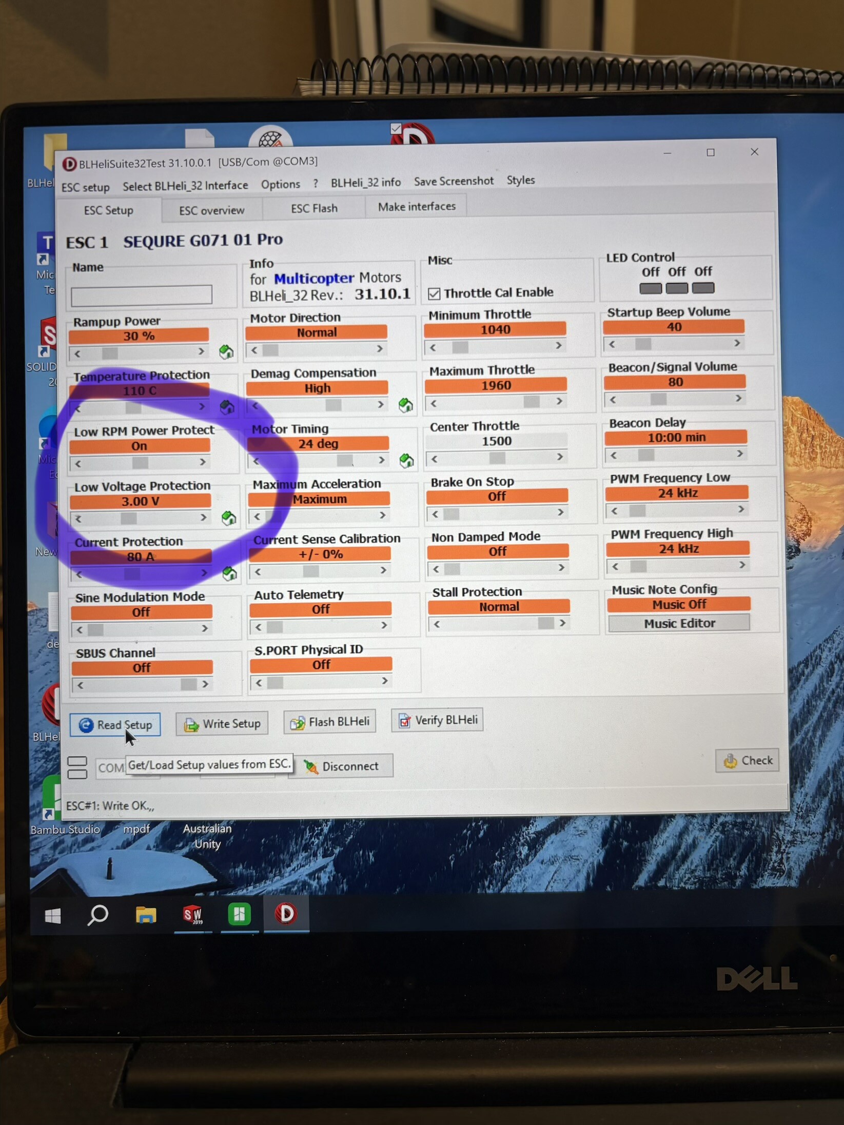

I just built a waist assist using the WP14200 and I am having an issue with low rpm output. Currently using a maytech remote and a battery that has been proven. All components have been working great with a different ESC but the sequre seems to be limiting rpm to 40 percent or so even though the remote is showing 100 percent at full throttle.
I did a manual throttle calibration a few times with no change. It has the same issue with a load or no load. Any ideas? Do I need the adapter to program the esc or should it work normally with the factory settings?
Had a different problem but maybe yours is caused by the same issue, turned out that the earth connection coming out of the small central tab with the 5v from internal bec isn’t properly grounded. Try connecting the B- feed to the receiver directly to the negative battery cable. Even though it measures as connected with a multimeter it seems that it’s some sort of floating earth issue.
Also check the programming - Low RPM Power Protect needs to be OFF (not as shown in picture!)
Thank you for the information. I will give it a try when my link device arrives.
