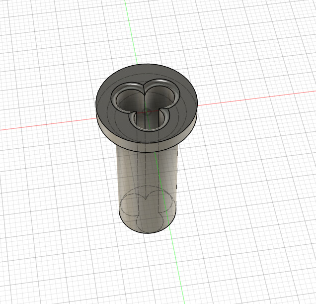

I have run 1 session with this ESC, AM32 version on 12s3p and it worked great. I don’t know of a way to record the esc temp but it wasn’t even that hot to the touch after a 30 minute e foil run. For the cable gland I 3d printed an adapter to run the 3 separate phase wires into the box. This would also work if you wanted to run the esc outside of the box and run the battery terminals and data terminals through the gland. I also used some marine silicone sealant on the cables and gland before tightening the gland, no leaks so far.
