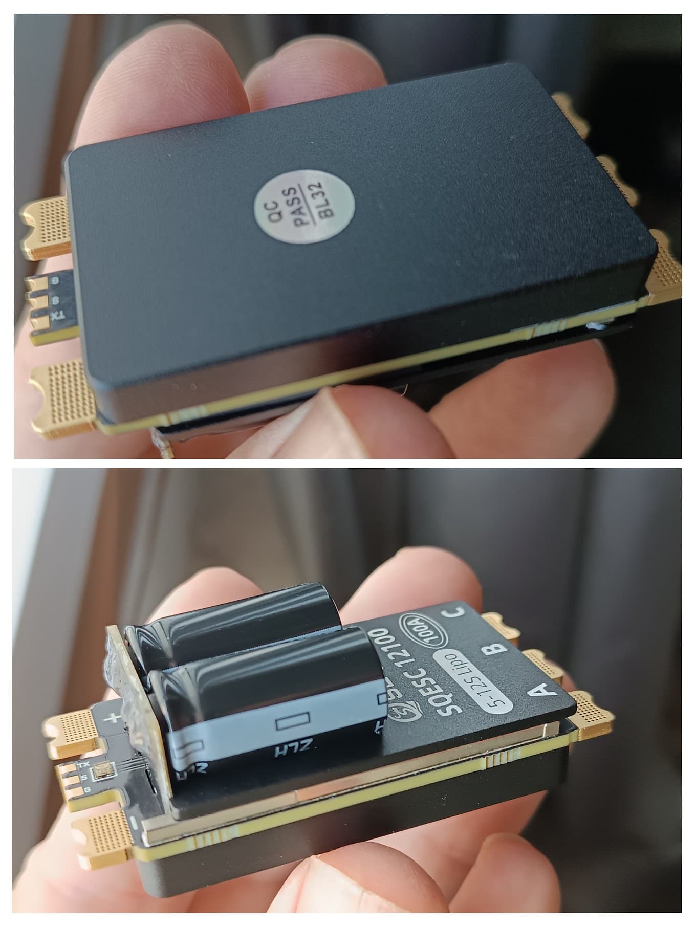

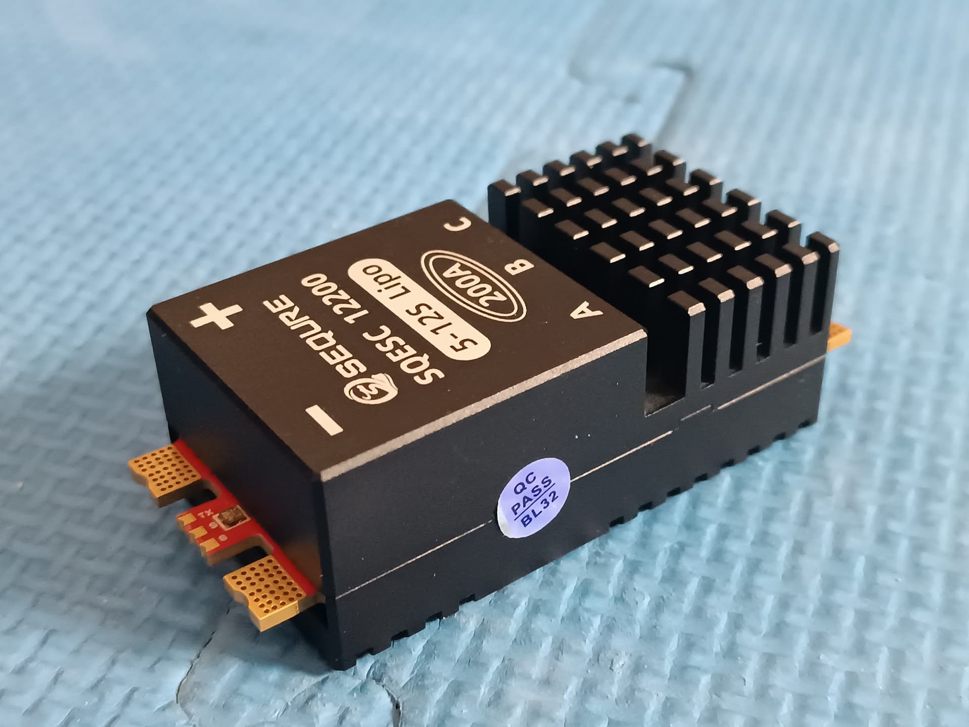

This is how 12200 looks on the outside:

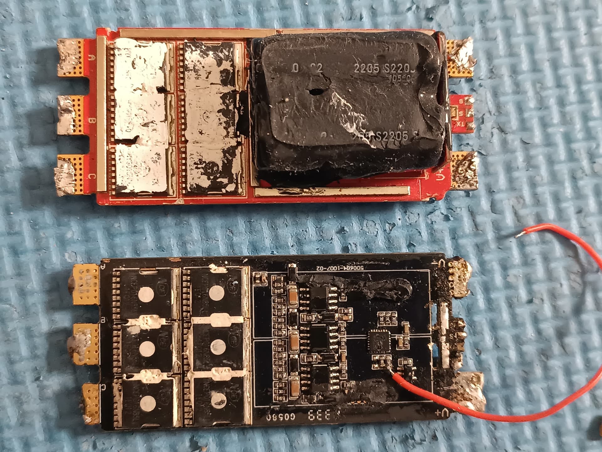

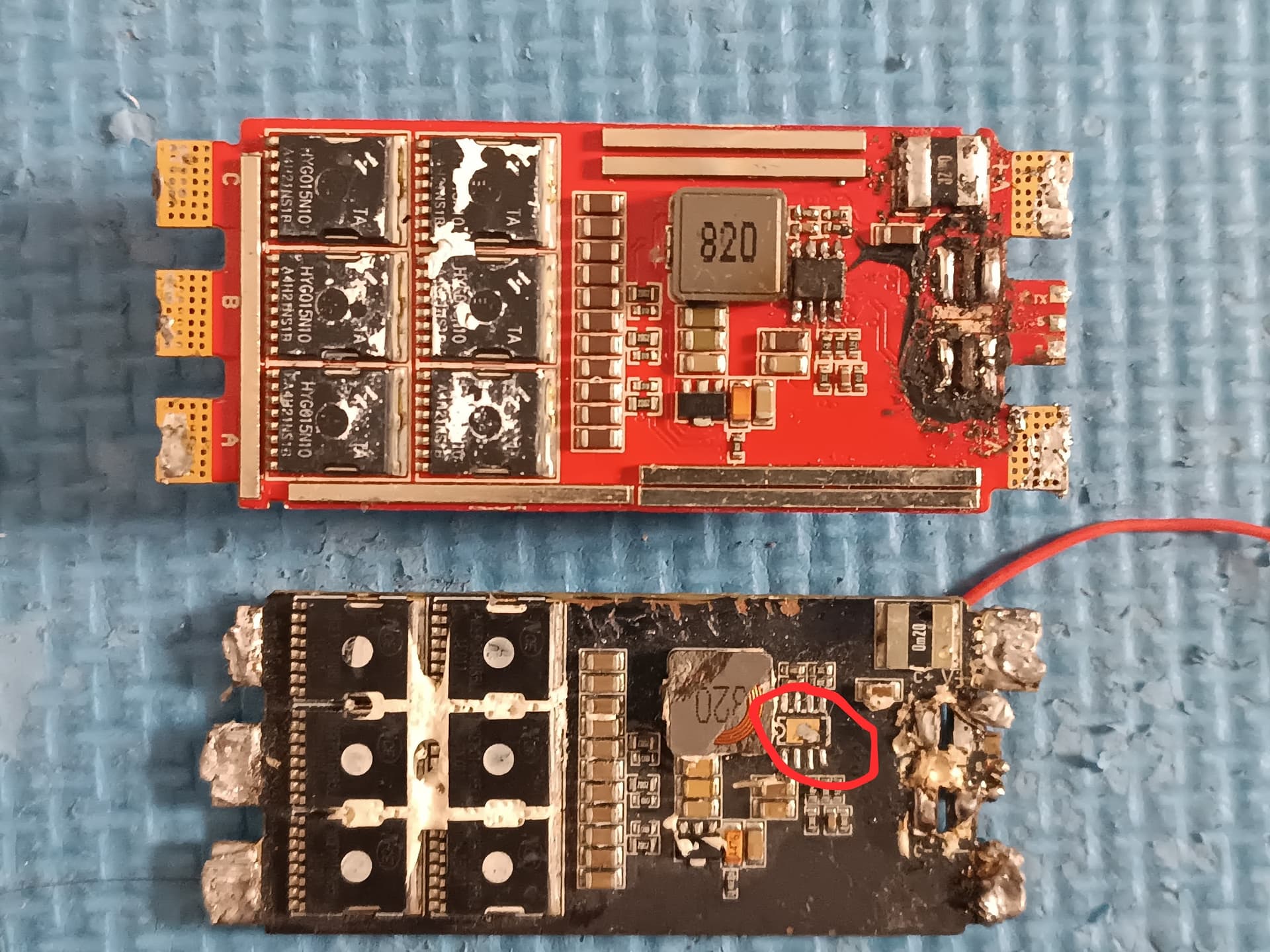

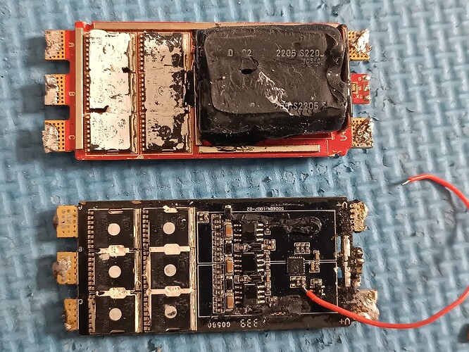

On the inside, on top is the 12200, bottom is xcross 160A (including the power managing chip):
The other side:

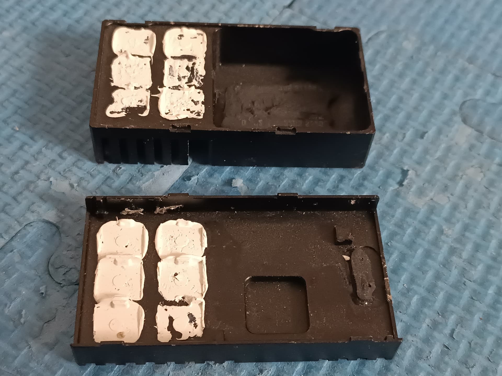

Aliminum covers:

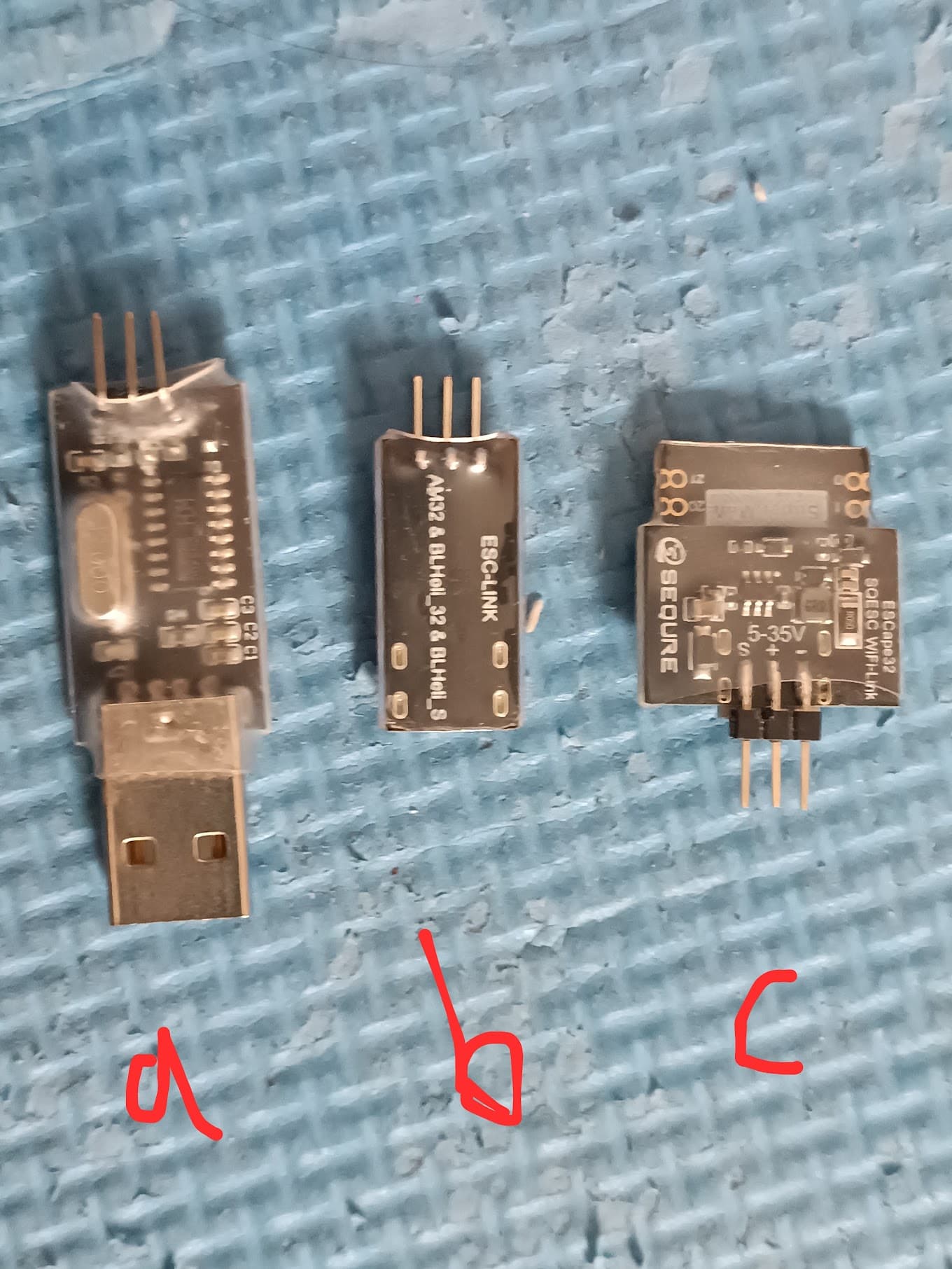

Programmers:
12100 esc:
12200 vs Xcross 160A
Despite being very similar and having almost the same components, 12200 got a lot of improvements (ones that I noticed, I bet there are more improvements):
  • Mosfets: Xcross - NCEP016N85LL 1.6mOhm. 12200 - HYG015N10NS1TA 1.2mOhm
  • 12200 telemetry in the blheli32 version is way more accurate, it can be relied on.
  • 12200 pcb has thick power rails - it can be seen in the photo
  • First and foremost difference is the encompassing cooling solution, it really works, esc stays much cooler. Notice that the two aluminum halves are not glued in the middle and they have only a thin contact area.
  • In the water I got the feeling that 12200 is stronger.

Programmers (a,b,c in the picture):
a. This one specifically works the best for blheli32 in old Windows. Only Windows. The new esc got a testing version, so download specific software from Sequre.
b. This works only for AM32 for me. Only Windows.
c. Only for escape32. Connects by wifi, configured in a browser.

While disconnecting programming wires of 12200, the power managing ic was lost, the esc would not draw any current. The chip number is SCT2A10ASTER. This chip is the same for Xcross 160A.

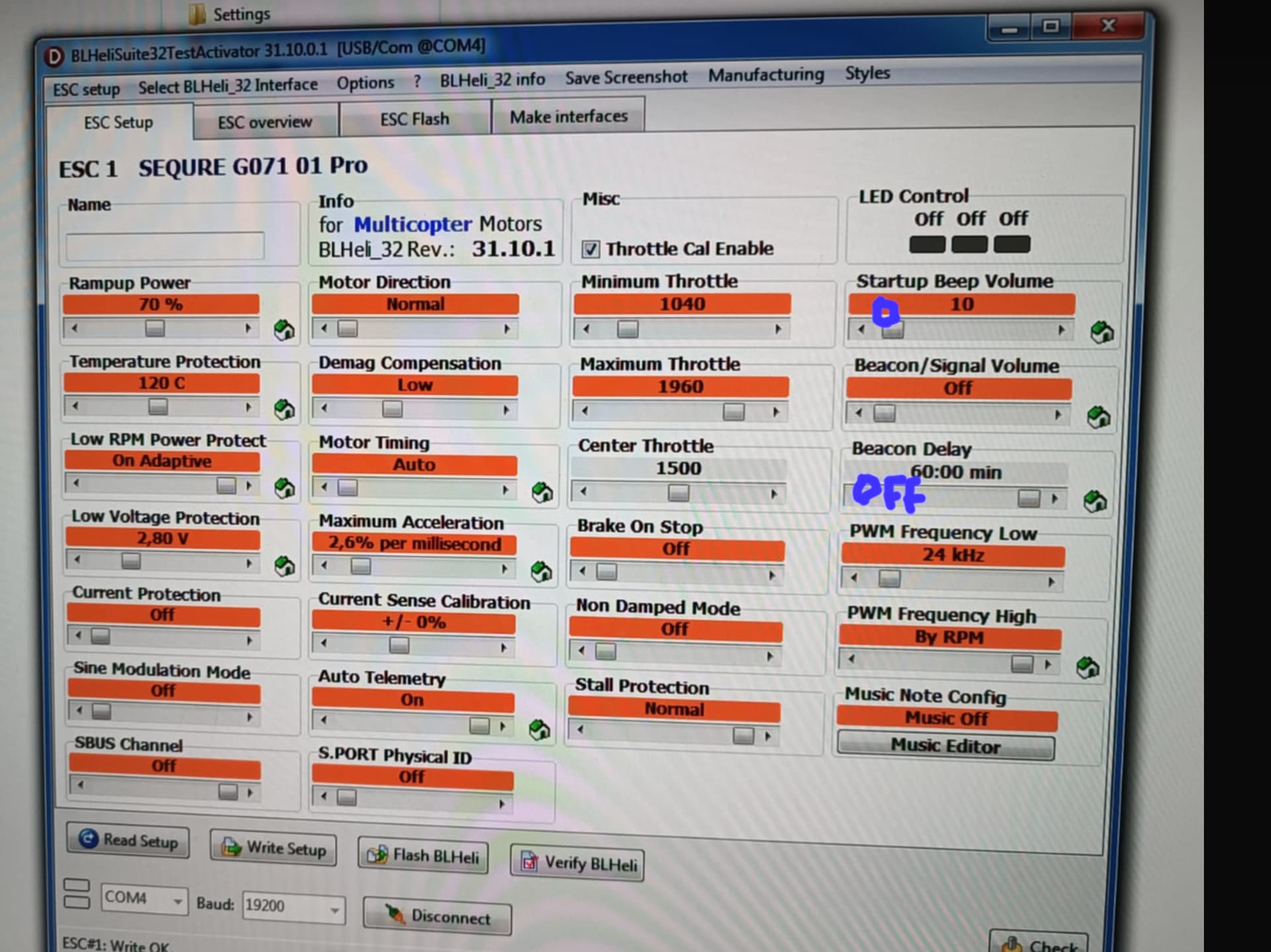

Has anyone encountered a desync or power cuts at high throttle? Above ~50% throttle the ESC starts cutting out / power loss (hard to describe, the vid with sound shows it better). Ive only tried the BLHeli version (both 31.10.1 & 32.10… 32.10 works a bit better, cuts out at ~70% throttle). This only happens under load - prop spinning in the air is no issues.
Interesting. Please post your settings.
And question - is this is 12200 esc with the testing 31.10.1 version, which is provided by Sequre? If so how you can program the newer version?
Here are the settings but I tried changing basically everything.
Yes correct, 31.10.1 version provided by Sequre and programmed using the ‘TestActivator’ BLHeliSuite version that they provide on their website. The 32.10 can be programmed using the normal BLHeliSuite version.
Try this:
Motor timing Auto
Stall protection normal
Maximum acceleration %2.5
Pwm frequency high by rpm
How can you program using 32.10 formal software? doesn’t the program yell at you that esc is at different version?
Tried them all other than PWM Freq to by rpm… i’ll do that and report back.
One of the 2 Sequre ESC i have is on 32.10, and that can only be programmed with the new software. This one somehow works better, got it off Amazon instead of directly from Sequre (no longer avail).
The main issue is on the formal 31.10.1 version ESC.
