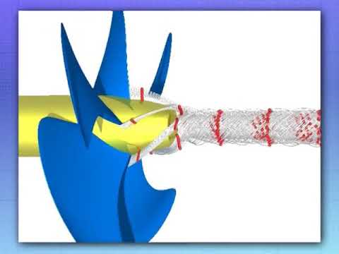

Nice. Is it a FR prop ? Would you test with and without the nose-shaped boss end ? I ask because David FR prefers straight, without cone (more silent).
Did you get any difference with and without The endcap.
It would be intressting to know if someone have done and tested a vortex diffuser to a FR propeller.
I would guess We should be able to gain some efficiency if we get a good shape to it
