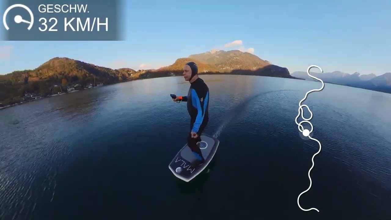

Yesterday after printing the new Hub for the 7” FR Propeller, I used the propeller first time.
So, Gong Veloce M and the 7”FR propeller.
Metr from yesterday:
Today i mount the Gong PRO MT with the 7” FR propeller. It is definitely a more stable setup, Mut the Veloce M makes more fun.
Metr from today:
