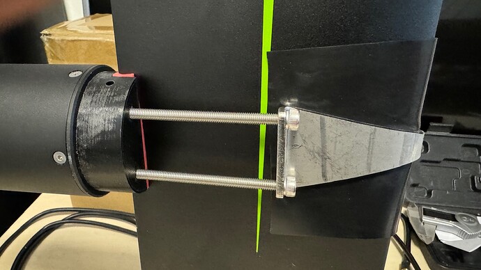

I’m using the winter to slightly improve my V1 & V2 Efoil. I’m specifically looking for a much stiffer mast. The Gong V1 mast tends to swing massively in the waves. Likewise, the long HA wings are almost impossible to drive with a Gong V1 mast. Attached are a few pictures of my new engine mounting system…
The gong V2 mast is a lot stiffer so that will serve you well. Apart from that i found the top plate slop is not a lot better on the V2 and this was (at least my) main issue with my gong V1 setup.
I wish they all could introduce a grip fit or conical interface for the top connections!
I have a core foil setup and also had slop in the top plate. I used epoxy to fix it and much much better feeling.
Wich Mastsystem are you using?
The 71cm kite version. Apparently the wing version is stiffer.
