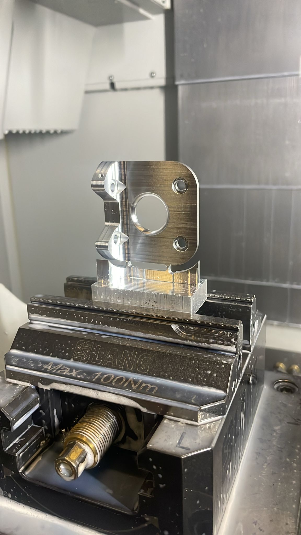

We have V3 motor mounts, but they are at this moment at the person who is doing the anodizing.
@kian. Are these for the 65161 bolt pattern and does it work with both the 17 & 19 mm versions of mast?
It’s made for the Gong V3 17 mm mast and the 65161 motor bolt pattern.
It might also fit the Gong 19 mm mast. A 19 mm mast is on its way, and once it arrives we’ll test it and let you know.

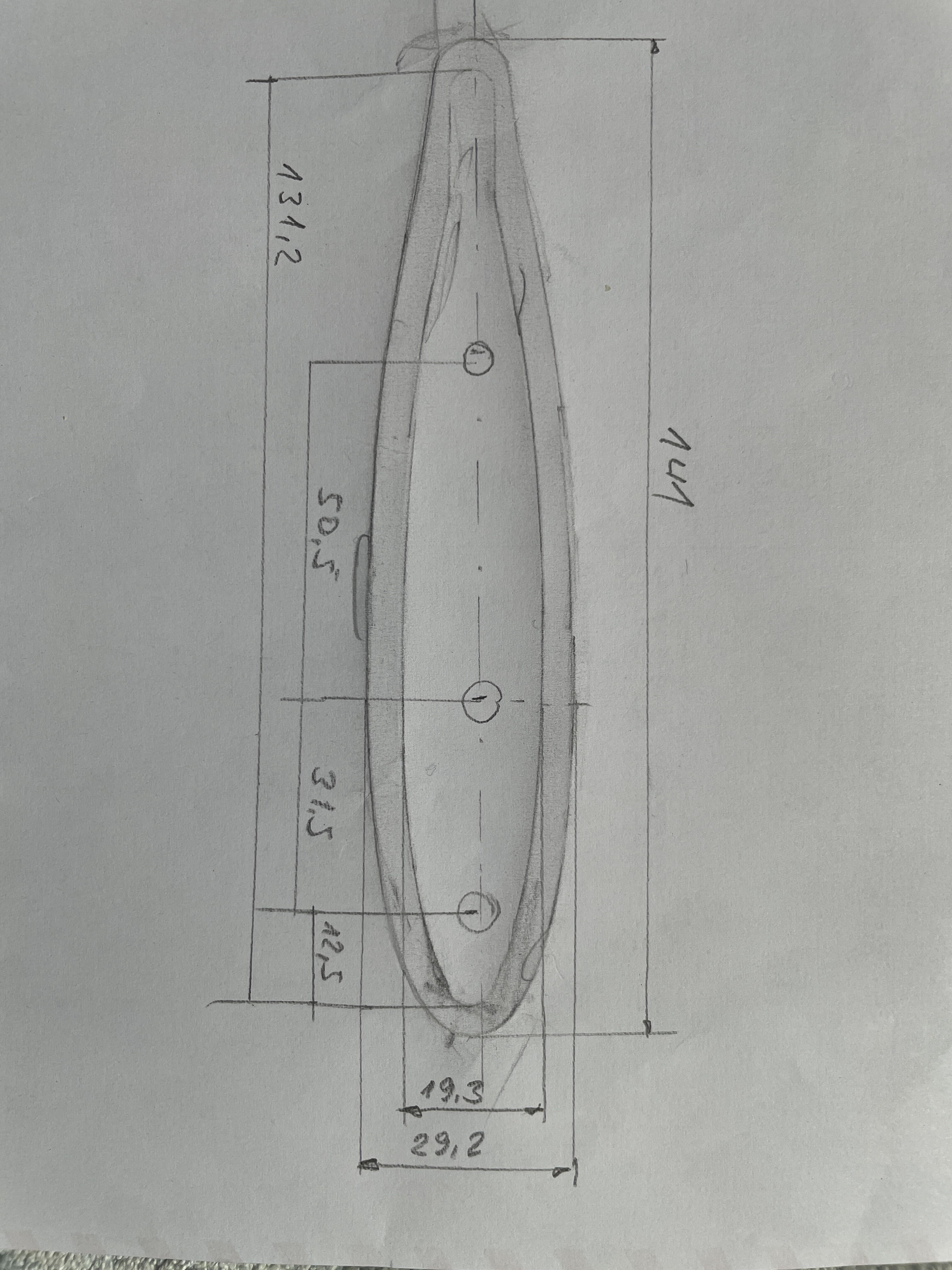

I put the measurements in the mast databese thread. You can use it as a canvas in Fusion360, scale according the measurements and then create a sketch following the outline.
