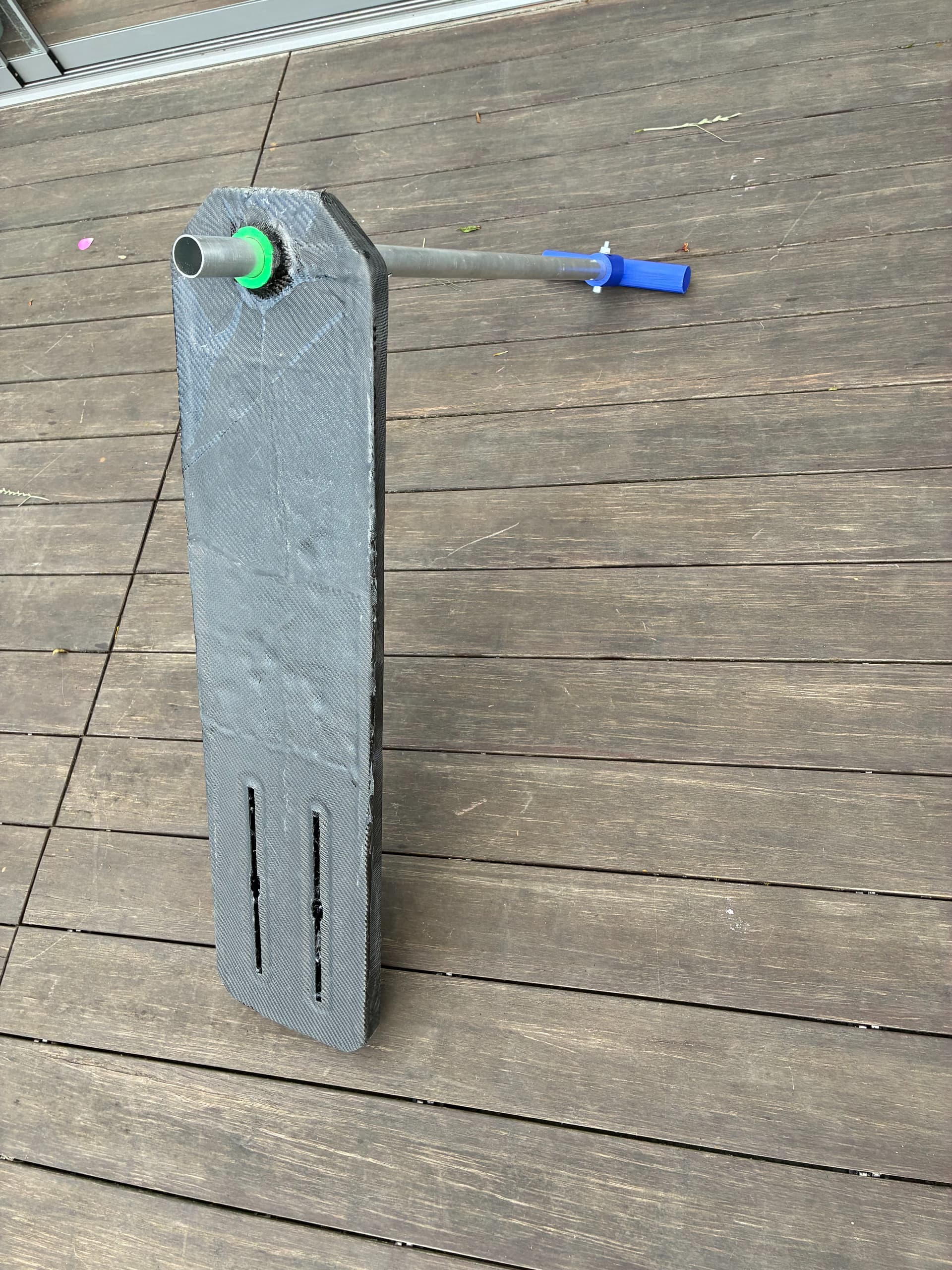

Had one week of great fun around Melbourne.
Most of the time on tow sometimes on backpack.
Thanks to Jonathan for his guidance!!
Everything works without any issue yet.
Next week Noosa Heads :-).

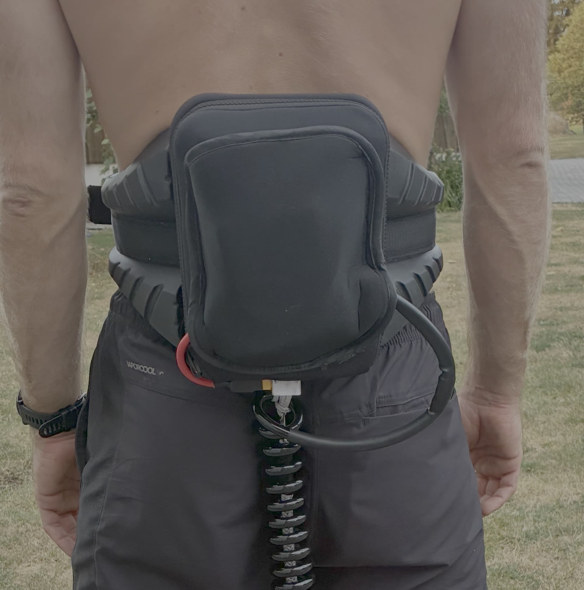

Will test this most simple waist assist as soon as our lakes are free of ice:
I used the following:
https://www.amazon.de/gp/aw/d/B08V5L57Y7?psc=1&ref=ppx_pop_mob_b_asin_image
It could be a bit thicker. Let me know if you know a better belt!

Wow! Your builds look awesome. I have a few questions for you if you don’t mind.

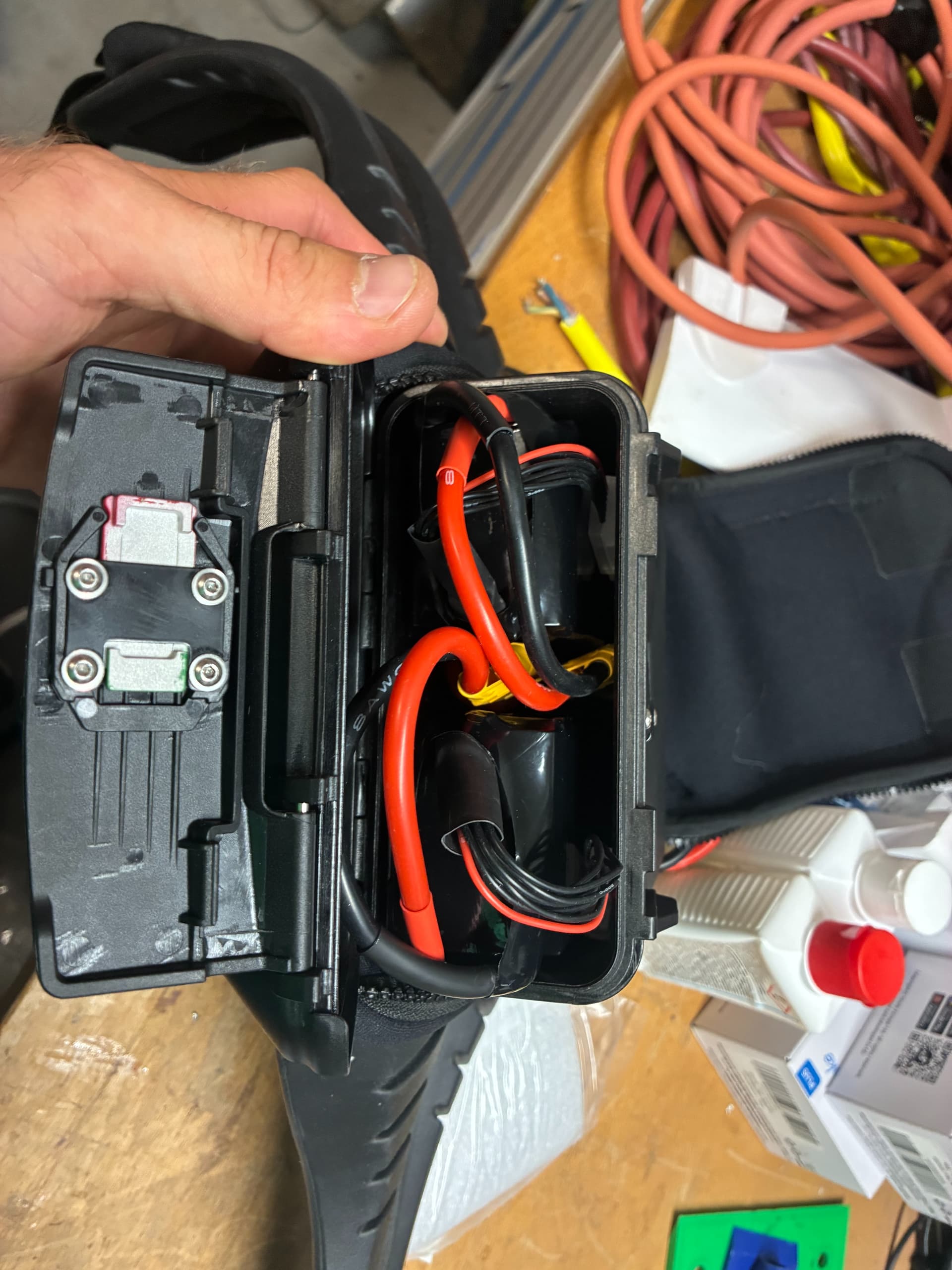

I’m planning to use a Pelican case on a waistbelt in saltwater. At one point you potted battery packs in epoxy. In another post you used plastic bags for extra waterproofing. Which method do you prefer? Did you have any issues with waterproofing when you were in saltwater in Australia?
Have you had any overheating issues with putting a (12s4p?) battery pack in the pelican case?
Are you still using these cells? (Samsung INR21700-50S, molicel, Tenpower INR21700-40TG)
Are you using a 6384 motor? 150amps max burst?
Thanks for sharing your builds! I’ve learned a lot from reading your posts already.
I am concerned about what happens if you fall and the contacts get exposed. Battery fire?
Plastic bag should be just a second level of safety.
Pelican case had a good quality and works well.
I am using it with 12s2p and 12s3p without any overheating issues.
Water on battery’s is really a safety issue (fire). In this case you should be able to remove the battery from your waist in time. Water on connector was no real issue for me yet.
150a phase amps is ok. can be less too…
12s3p
Tested the waist belt a few times in the waves. Its my favorite solution for an assist.
The belt could be a bit more solid.

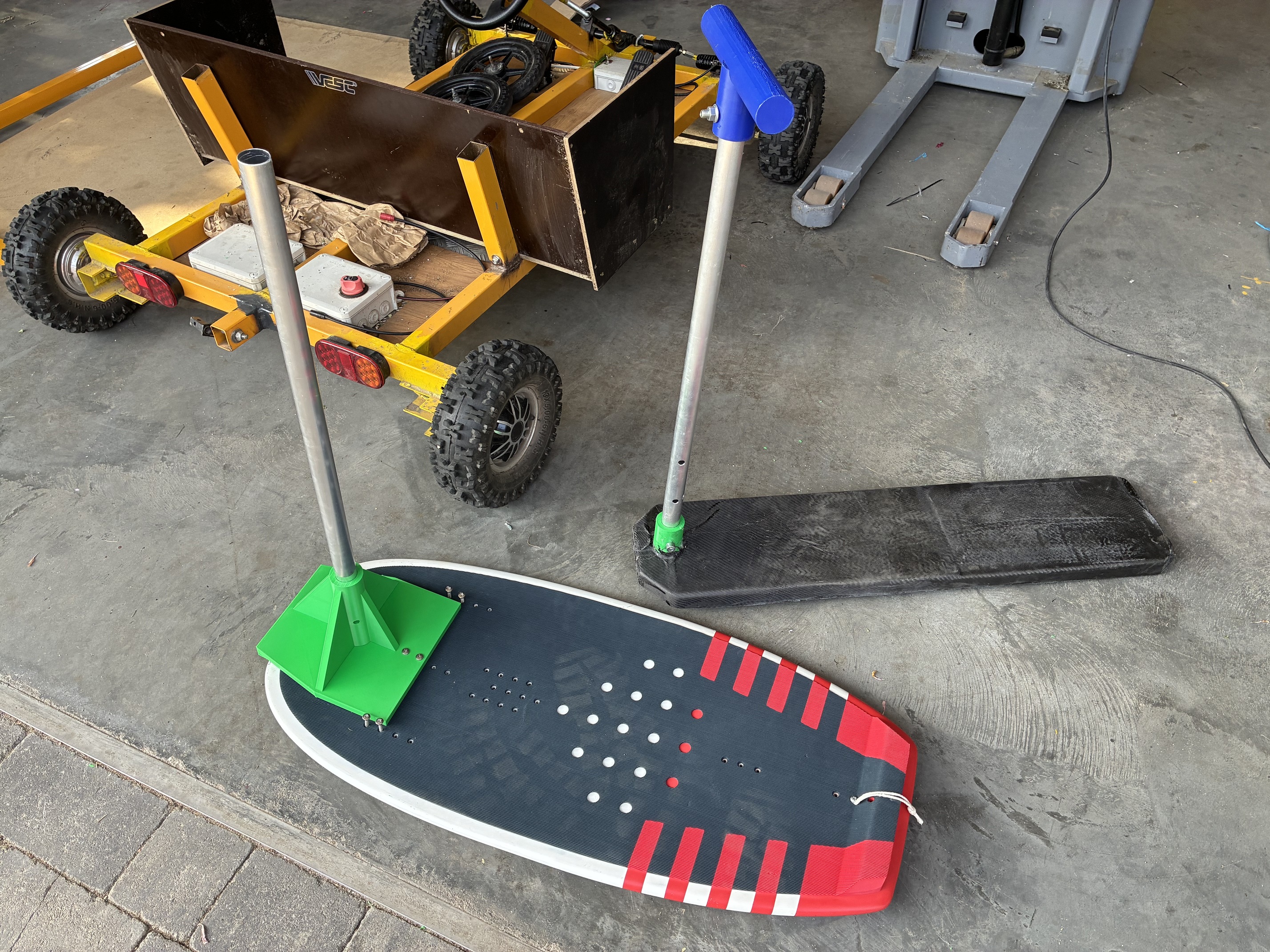

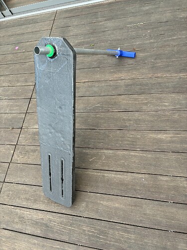

Building a better foil scooter to teach my kids pumping:

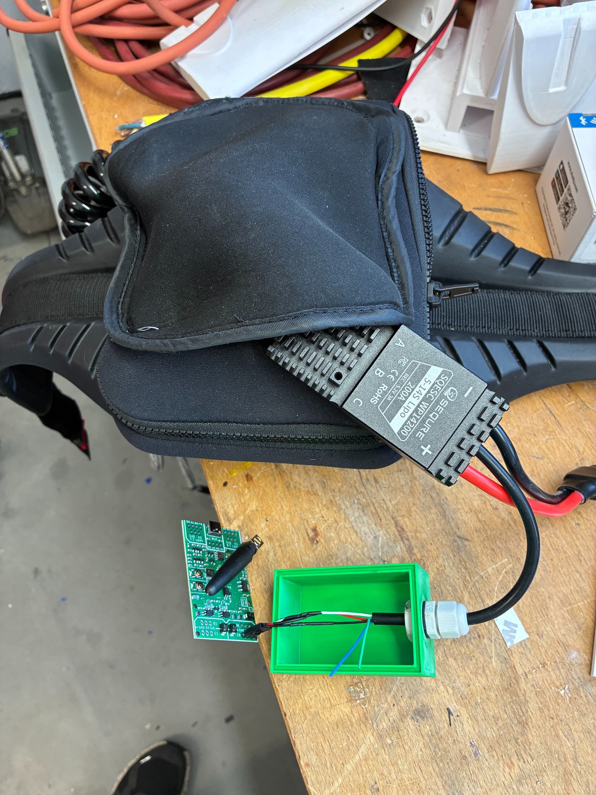

I have seen the duotone waist belt projects here. Since i was not really happy with my belt I had to test it:

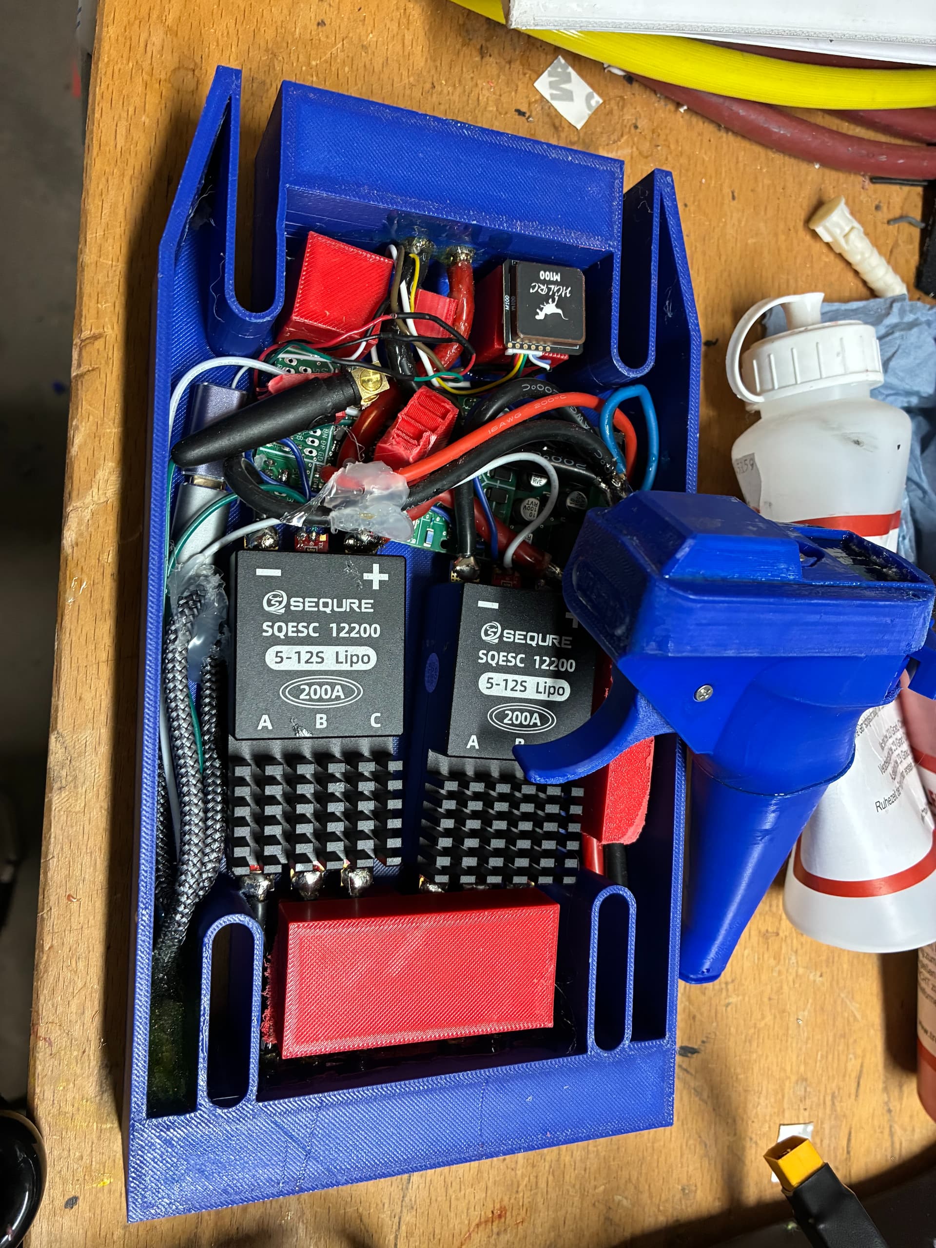

I am running two 15AH racepow semi solid state batteries inside:
ESC and receiver is outside the box:
My wife teached me how to sew the bag outside :slight_smile:
After everything was finished I realized I forgot the battery cable to the RX for battery measurement.

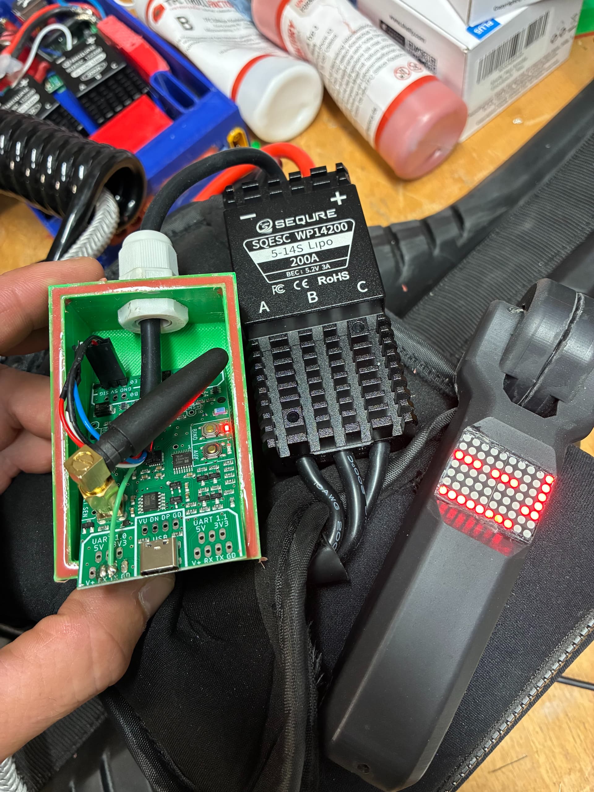

Therefore I decided to add KISS telemetry (for SEQURE ESCs) support to bremote.
See adding KISS telemetry data source · robertzach/BREmote-V2@478d3e9 · GitHub
working great. Love the open source approach of bremote!
@ludwig_bre yes, a smaller RX is needed :slight_smile:

I like that, I hadn’t thought of simplifying the setup by just using an IP68 ESC on the outside like that.
Looks really good. Which waterproof battery connection did you use on the downside of the box?
