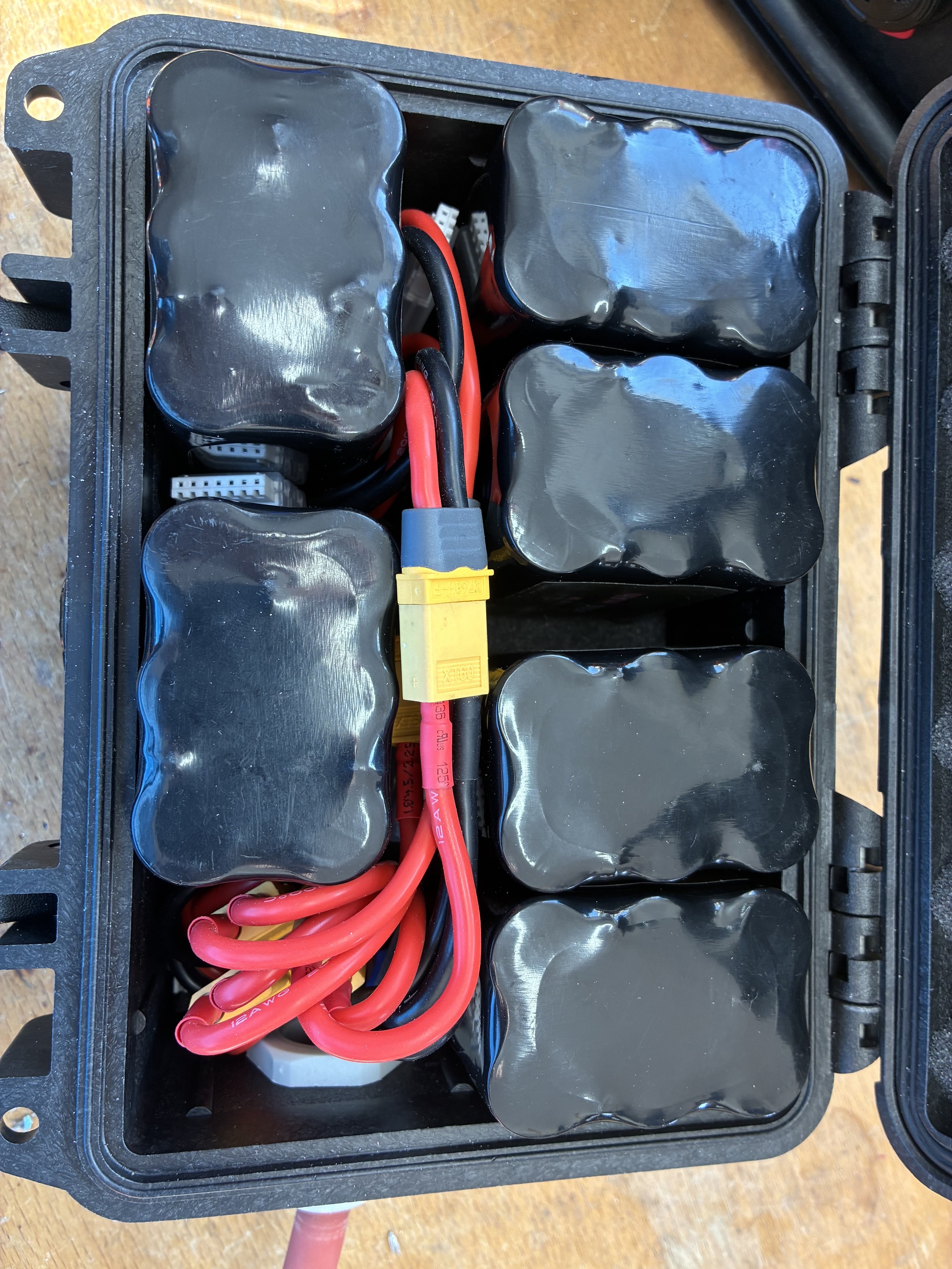

I am concerned about what happens if you fall and the contacts get exposed. Battery fire?
Plastic bag should be just a second level of safety.
Pelican case had a good quality and works well.
I am using it with 12s2p and 12s3p without any overheating issues.
Water on battery’s is really a safety issue (fire). In this case you should be able to remove the battery from your waist in time. Water on connector was no real issue for me yet.

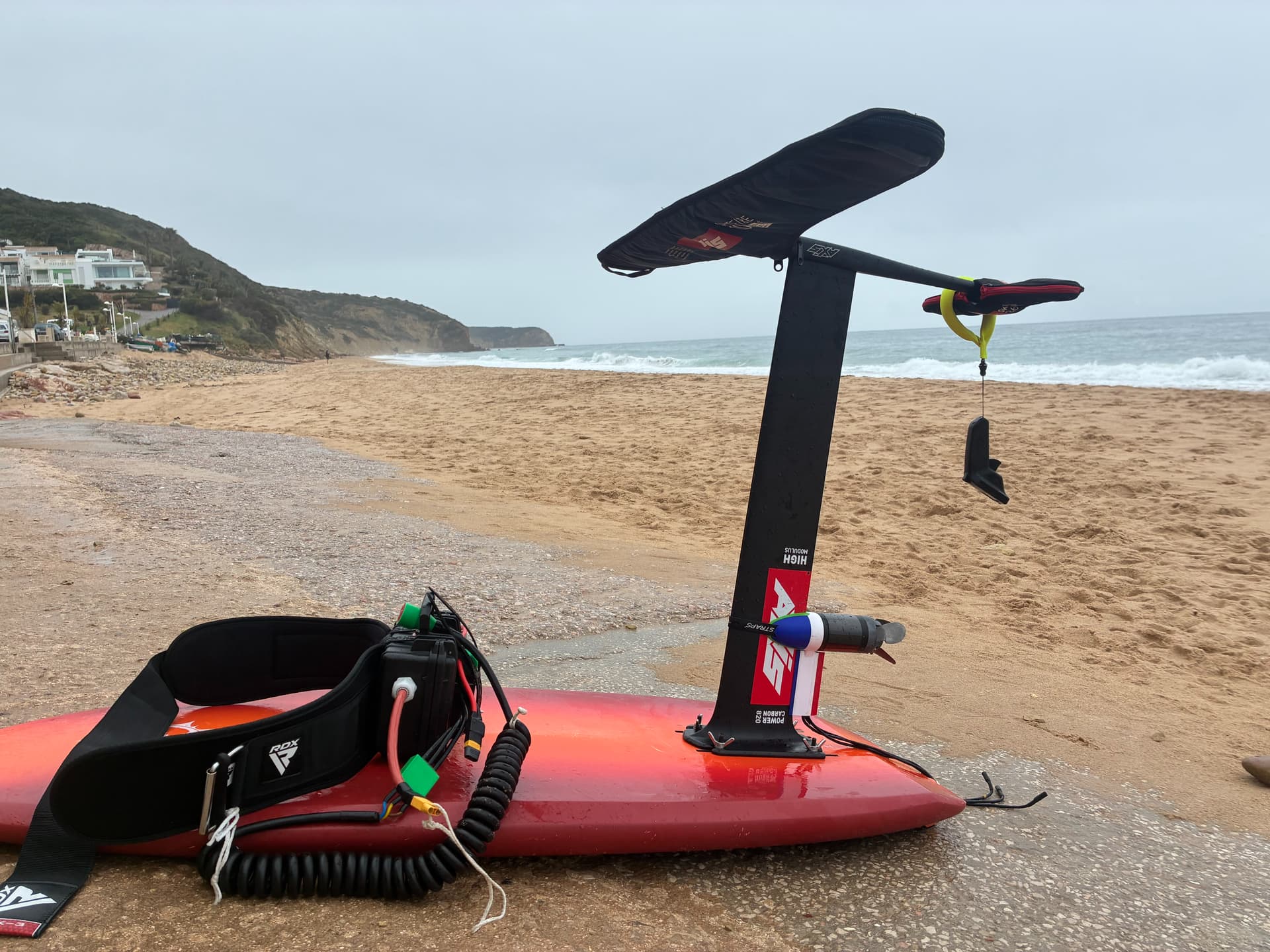

Tested the waist belt a few times in the waves. Its my favorite solution for an assist.
The belt could be a bit more solid.

I have seen the duotone waist belt projects here. Since i was not really happy with my belt I had to test it:
I am running two 15AH racepow semi solid state batteries inside:
ESC and receiver is outside the box:
My wife teached me how to sew the bag outside :slight_smile:
After everything was finished I realized I forgot the battery cable to the RX for battery measurement.

I like that, I hadn’t thought of simplifying the setup by just using an IP68 ESC on the outside like that.
Looks really good. Which waterproof battery connection did you use on the downside of the box?
