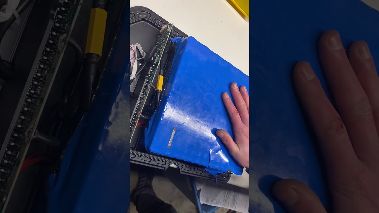

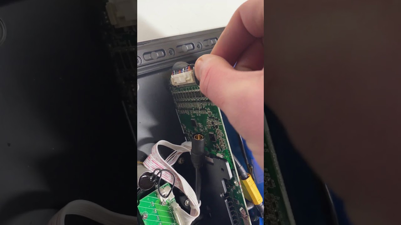

It os crazy that someone could defend waydoo manufacturing quality! Just read waydoo response above it is clear they have no idea about basic safety and regulatory standards please go read! Lithos is US based and you can take legal actions if their battery malfunctions plus just compare both packs tear down! While I am not a fan of lift battery pack which I believe it has room to improve, it much better quality and has bunch safety features provisions compare to waydoo which looks like a fast built diy pack in nice abs box

I am the one that opened the Lift battery.
The difference between the lithos battery construction and waydoo’s is like comparing Porsche build quality with a barbie car’s.
It might not be obvious in the pictures to everyone, but the waydoo battery internals look like something out of a toy and the lift internals would look at home in a well engineered car or airplane.
Example: There are two to three orders of magnitude more in expense and effort put into fasteners and connectors inside the lift battery (multiple types of epoxy, polyimide film tape, nordlock washers, high quality bolts, integrated anchoring to the case for every component, all wires carefully secured with zip ties to each other or anchor points, a battery cage structure, sleeved power cable, etc.)

We are talking about the quality and safety of waydoo battery based on tear down photos! Plus Waydoo guy comes and says it is IP67!! Do you understand what does it mean? Means all those waydoo packs out there going to leak in salt water and cause fire eventually If we as a community don’t inform the owners asap! Plus Waydoo says it passed UN 38.8 which he confuses with UN 38.3 and that makes me think these guys have no idea about seriousness of the problem!

Yes! They are cutting too many corners, a marine battery of that size has to be designed better. I will post a few more pictures so everyone can see for themselves.

Thanks for the photos… This batterypack looks nice to me… No cheap cells, high quality Sony 18650… and some smart ideas and maybe a few to improve… Is there any name on this plug, so we may search where to get this?
