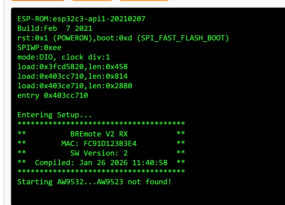

This is what i got
That means Rx firmware is uploaded to a Tx board
Please upload Tx firmware according to the video I made
Sorry, I made a mistake in the line.
I’ve now updated TX again and now it works.
