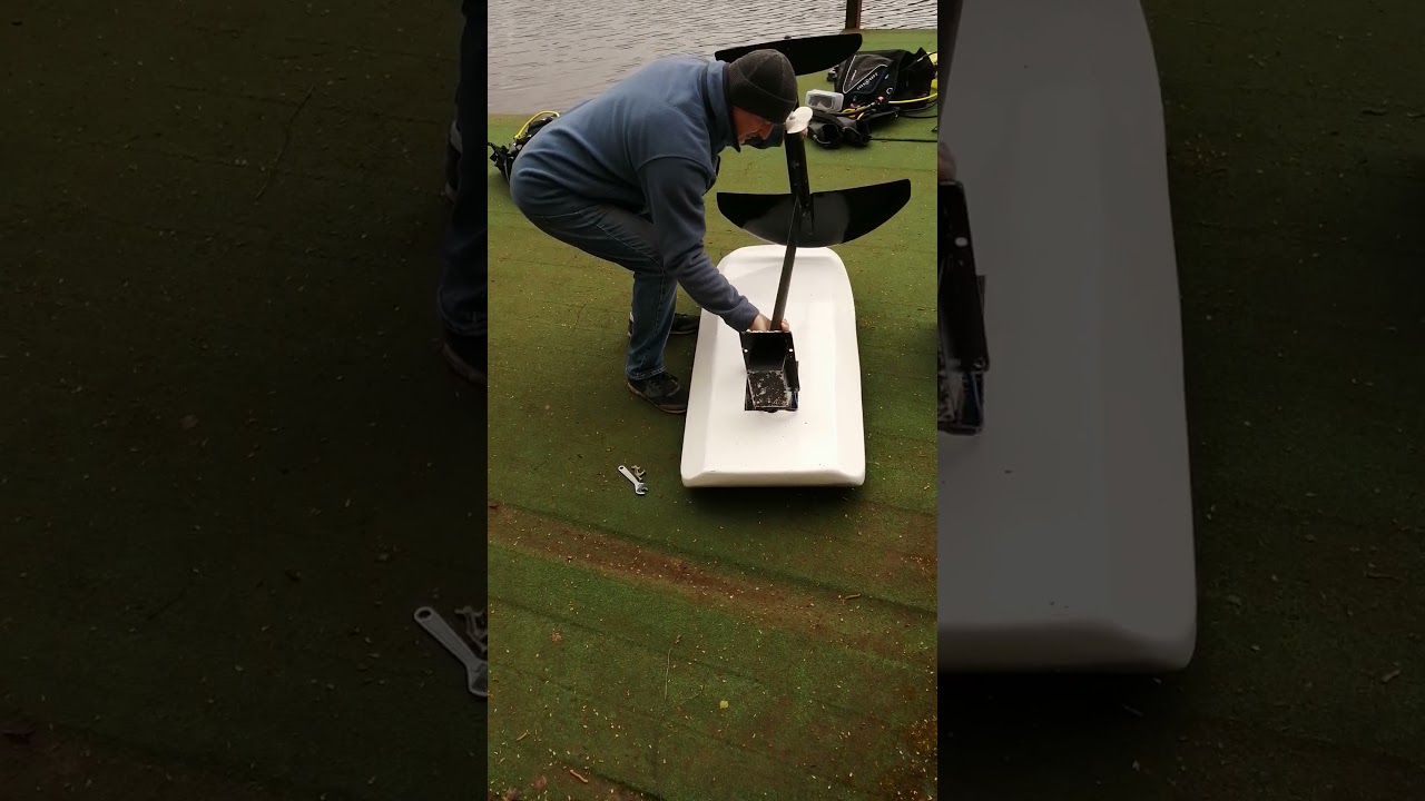

Even 6mm.It’s not even pure aluminum, but some kind of alloy. What they found, they made of it! More work for the whole summer! We have two builds. Still putty, skin, output, paint and design. And the remote control needs to be improved. Thank you all so much for your advice! Without your help, the work would have taken much longer!

Well, friends! I finally finished my second build! Half a year of life! I’m a little tired! I decided to leave the design for later. And now everything is locanic, black and white! In the meantime, we ride and have fun!
White and black! We tried the wing that we found at the bottom last year. It is 1100 square. And they were able to stand up, but at a higher speed.
