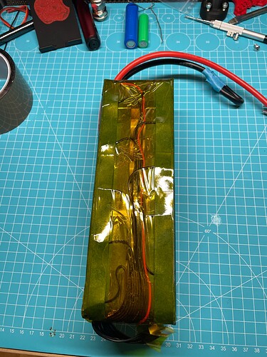

10S3P Build.
My 10S3P is finished!
I used 0.2mm pure nickel for the cell connections.
Now I can build the second battery

Top notch every time you post, amazing job!! Can you please show how you connected the main + & - 10AWG wires to the battery? Is it just soldered on the two ends of the parallel groups?
Thanks.
Unfortunately I didn’t take a picture of it.
As you write, on the first parallel ground bridge and positive bridge. First I soldered the cable to the nickel strip between two cells where there was space.
Then the nickel strip was welded on.

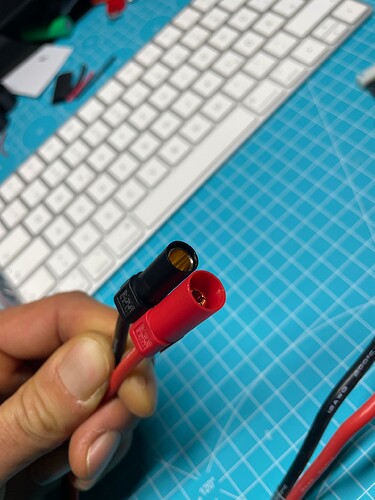

I have been planning that would I use bullet connectors, I would print like a dual socket, such that insertion will be possible only one way - red to red, black to black…

The XT150 connection cannot come together. Unless you’re stuck in red on black. The XT150 plugs can be glued together to make it a pair.
I see, didn’t know the black and red are distinct…
