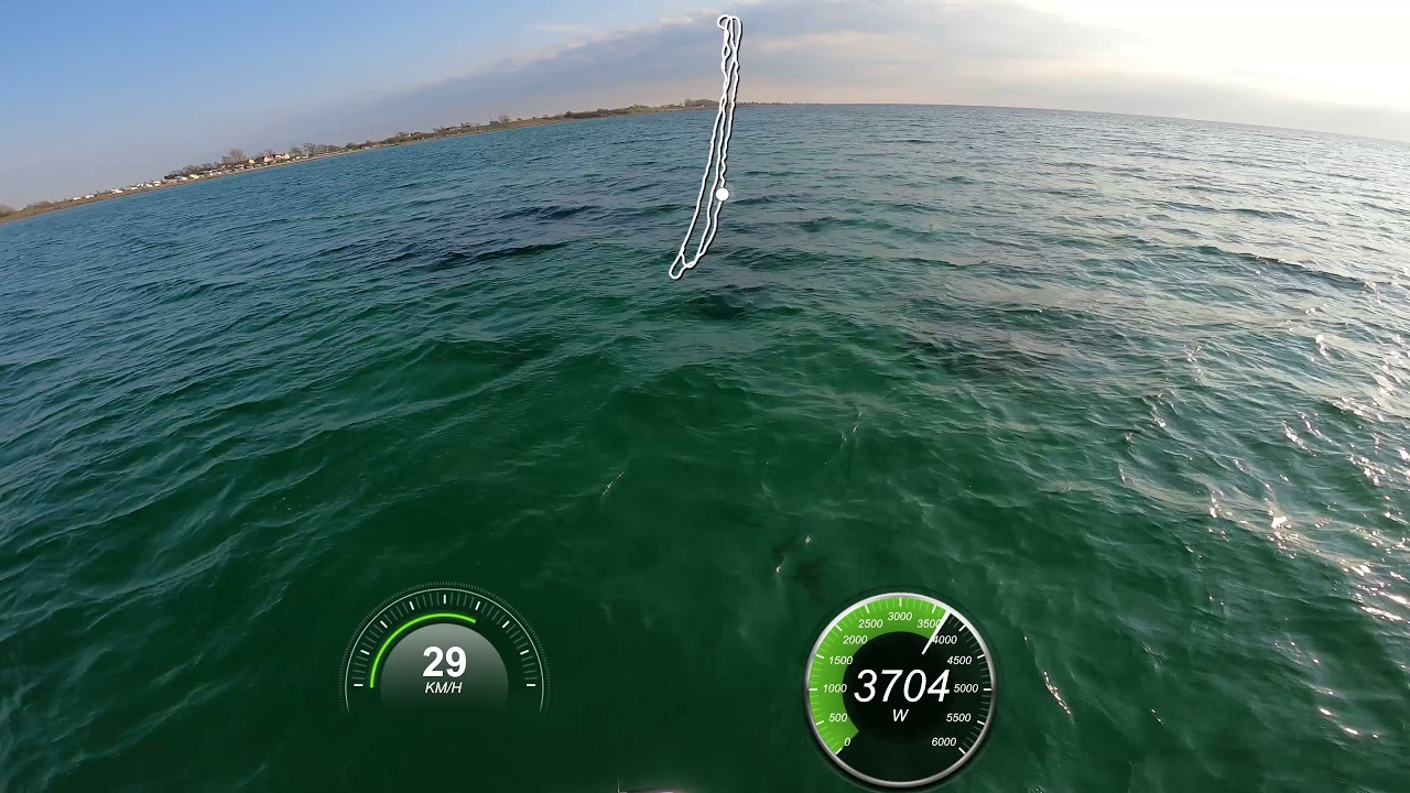

The setup is just magical. I thought having the frontwing in plane with propulsion was marketing from Flite, but it does really improve stability. Rig is super stable starting at 30kmh. I’m 105kgs on a 800cm2 front-wing so this is not bad.
Anyways since it’s still 7* waters and there was 50cm waves, I chickened out at 45kmh, but this was far from current or DC limit.

but at 30km/h your pulling quite a lot power… I ride with about 1800W at 30km/h with 80kg…on flipsky…and flite prop…so you use about 1000W more on FR 7"?
80kg total weight? Or just the rider?
Big diff upwind/downwind. Not so easy for you to know, but you need to look in both directions. This is absolutely not my most efficient setup. Its a 800sqcm wing for 135kg total weight! But it was a very unique experience compared to gong Veloce, RL, Naish, Unifoil hyper setups that i all ready have.
62Wh/km x 30km/h = 1860w
Yep, I guess you are both right, but the momentary consumption is not fully correct and also I have about 3v @40A. I would say 2,0kW to make it even.
I have the exact same @30kmh when I ride my Unifoil Hyper 190, which is a super efficient foil.
That one I can ride with 22A @24kmh thought.
All about which speed and how fat you are that plays in most
Secondly how high you ride, with 19mm mast it needs to divide some water, this seems to play bigger role in higher speed…
