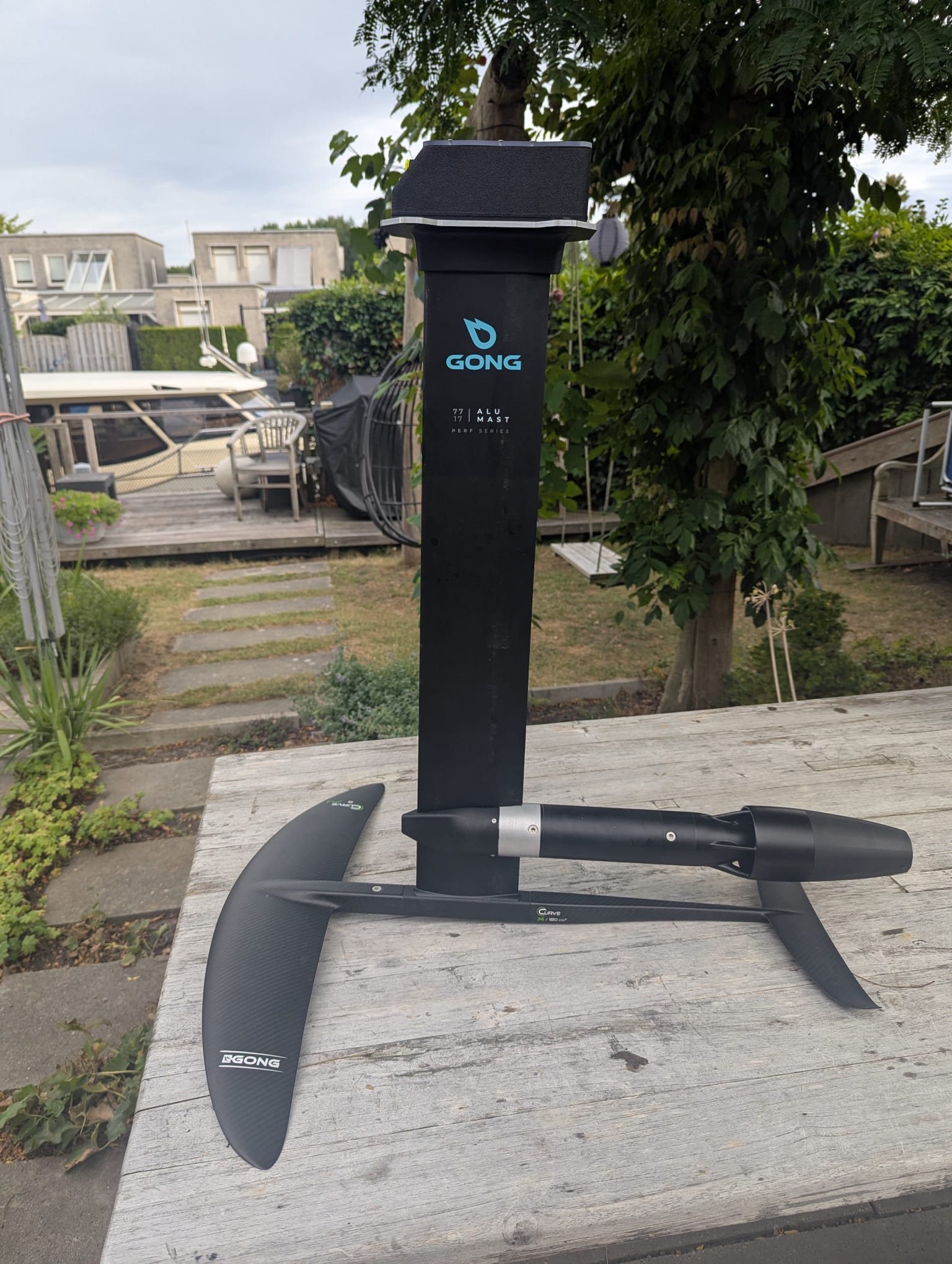

Frankenstein build (Fliteboard, Gong V3 mast and in my case a JetWave JET)
So today we finally managed to do the maiden of our jet-driven eFoil.
Setup:
  • Fliteboard Pro
  • Gong V3 mast with our new V3 Gong <> Fliteboard adapter (more info soon)
  • Old Gong wing (forgot the size, will update later)

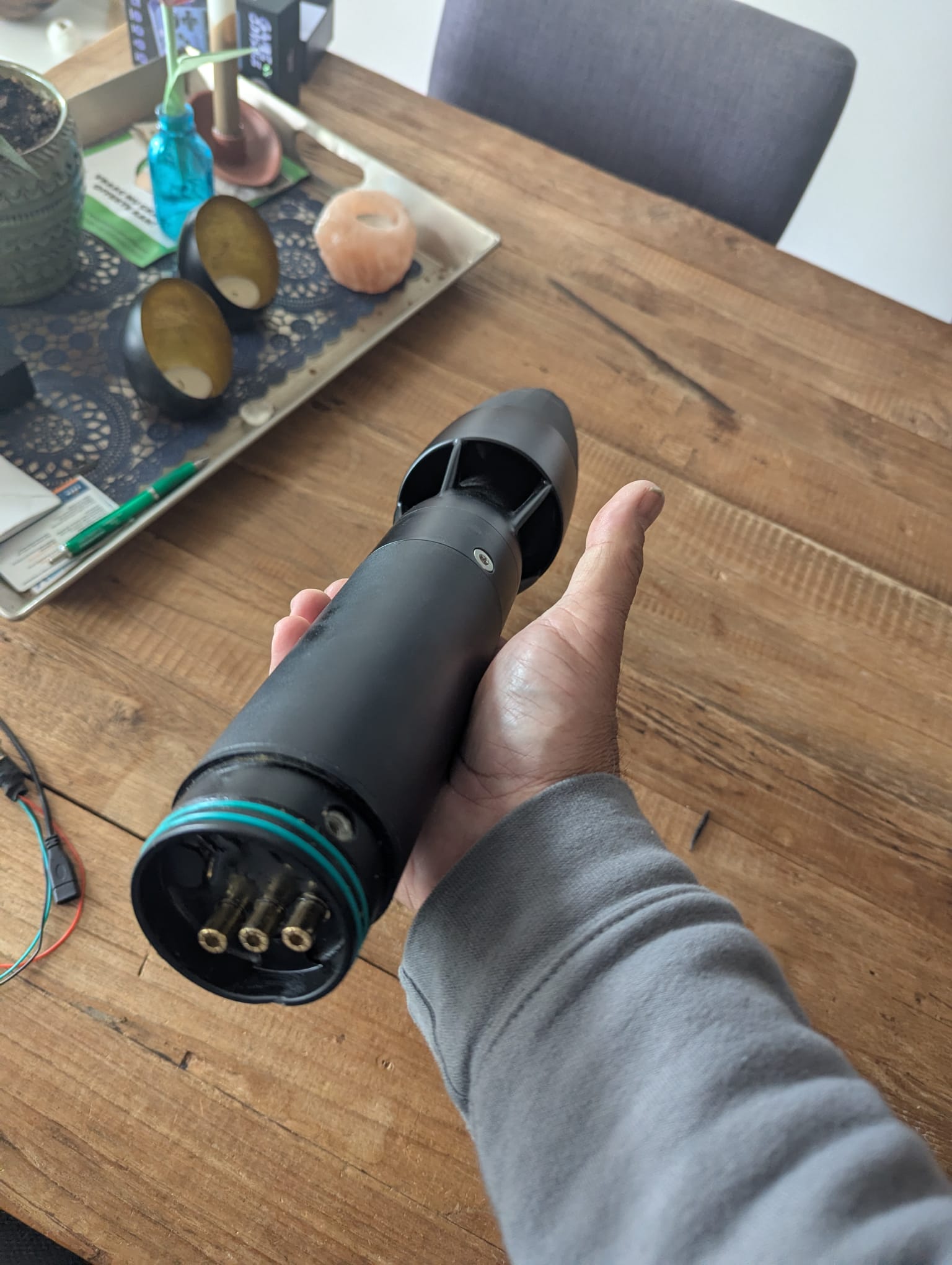

  • JetWave motor (no data available, but from our calculations/measurements it’s a 270KV motor with 16 poles / 8 pairs)

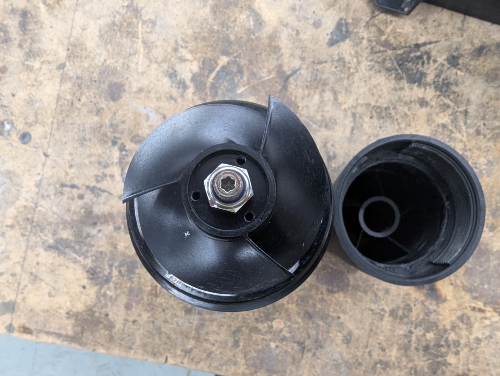

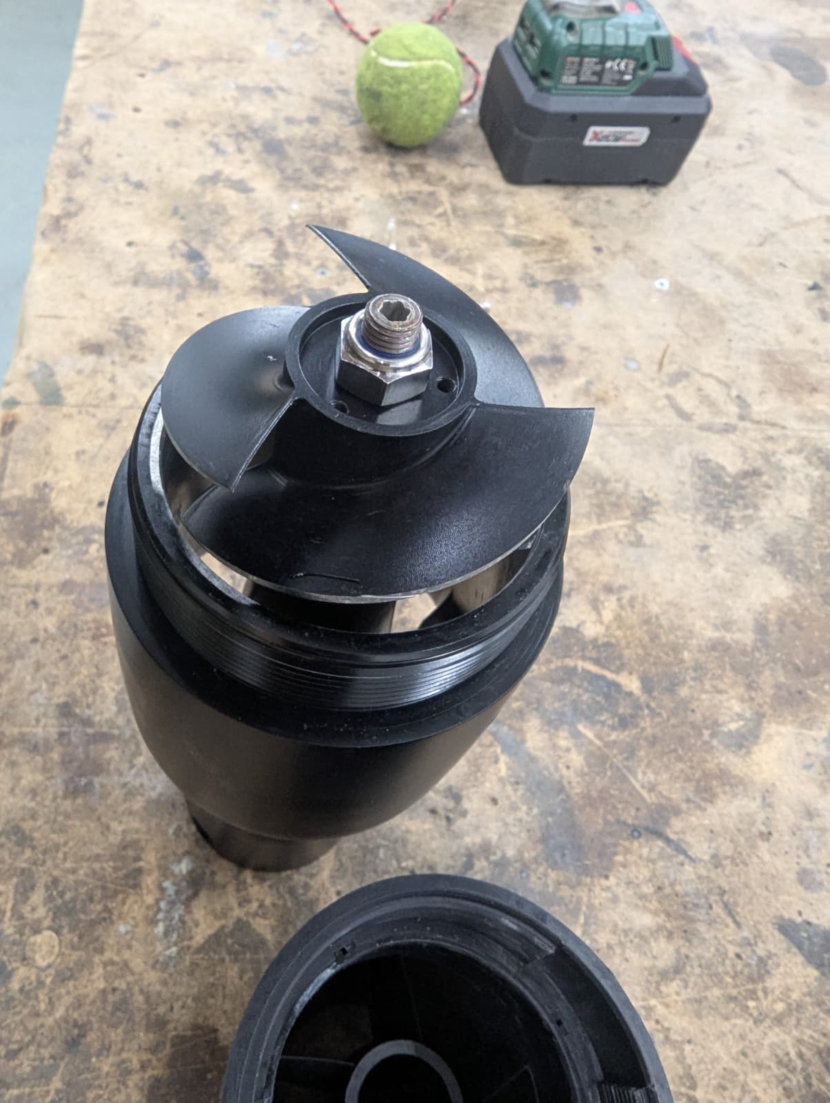

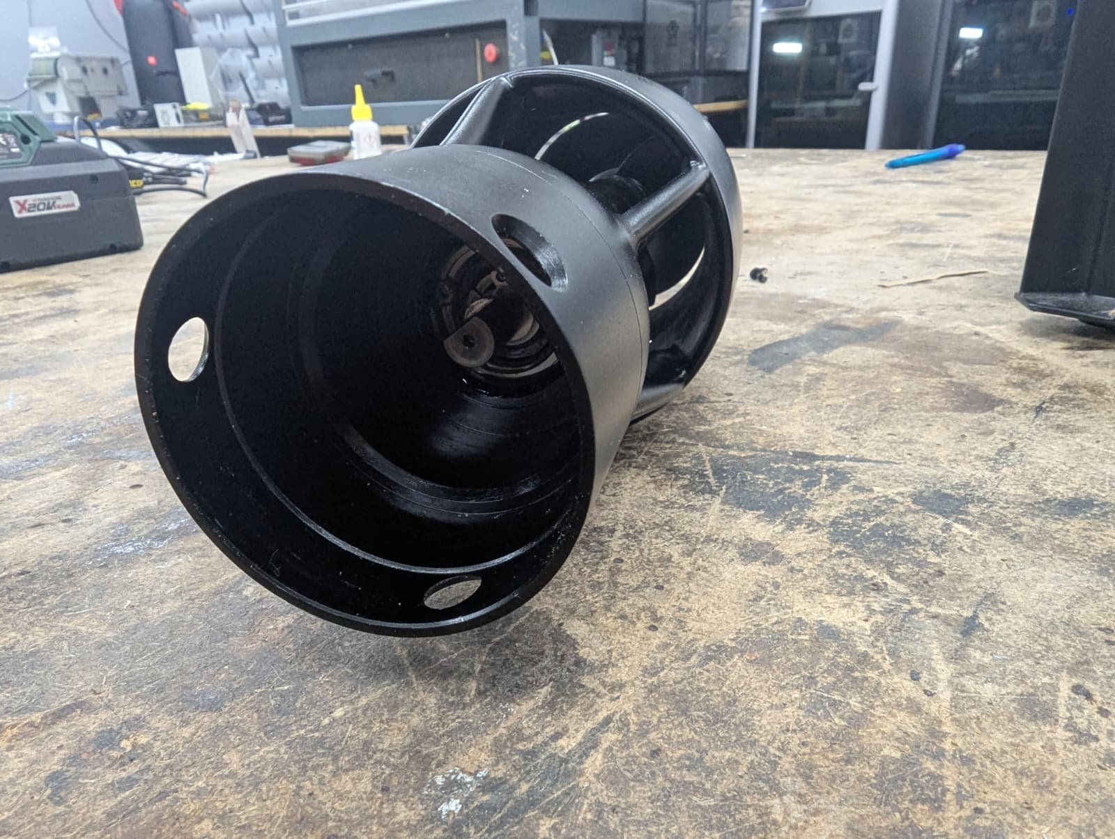

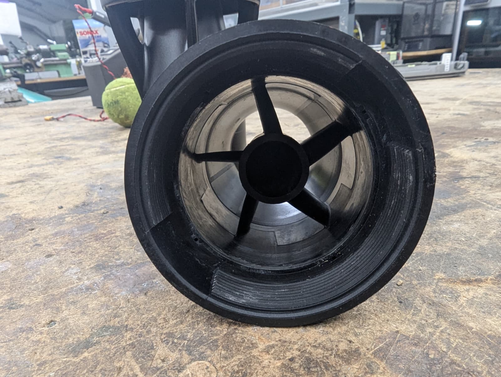

  • JetWave jet (not like all the others! It’s a real jet, not a ducted fan)

One more thing. The plan is to get rid of the backpart of the fuselage, and connect the stab to the jet

Thats really interesting. The drive looks very similar to a seadoo setup where the blades are super close to the duct.
How was the sound? Did you have lots of power to get up on foil?

During testing, we needed to run just the motor.
On 12S, not limited, it reached just under 12,000 RPM. Wow… what a sound!
It was almost scary, but in the water it’s nice and quiet.

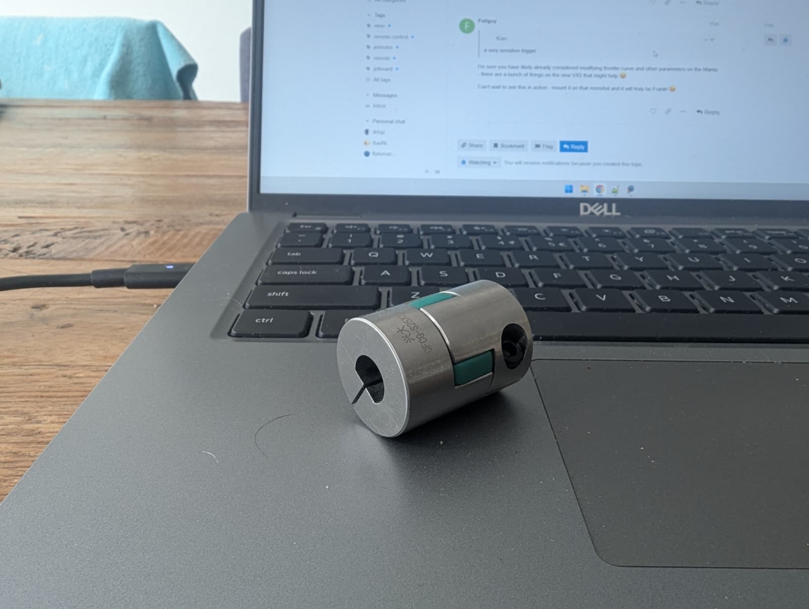

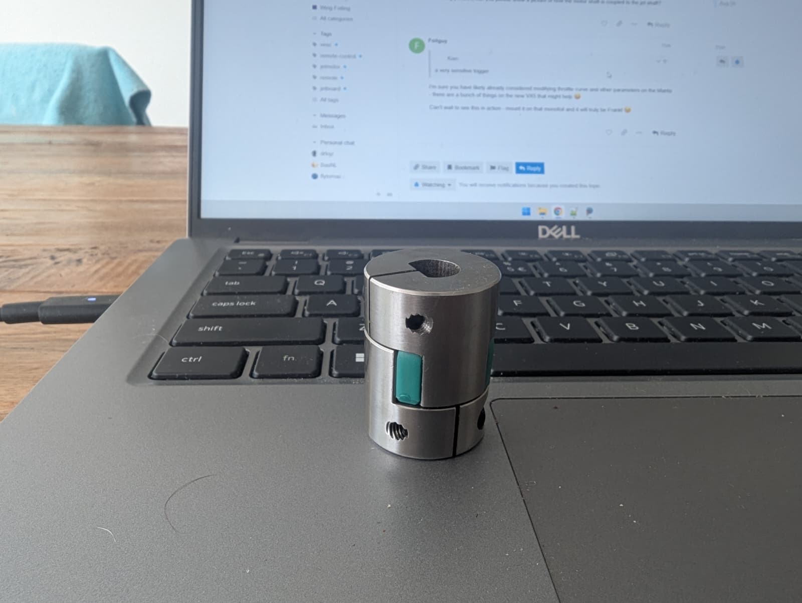

Interesting pictures, can you please show a picture of how the motor shaft is coupled to the jet shaft?

It’s a flexible shaft coupling made of stainless steel.
Size: OD 25mm, Length 34mm

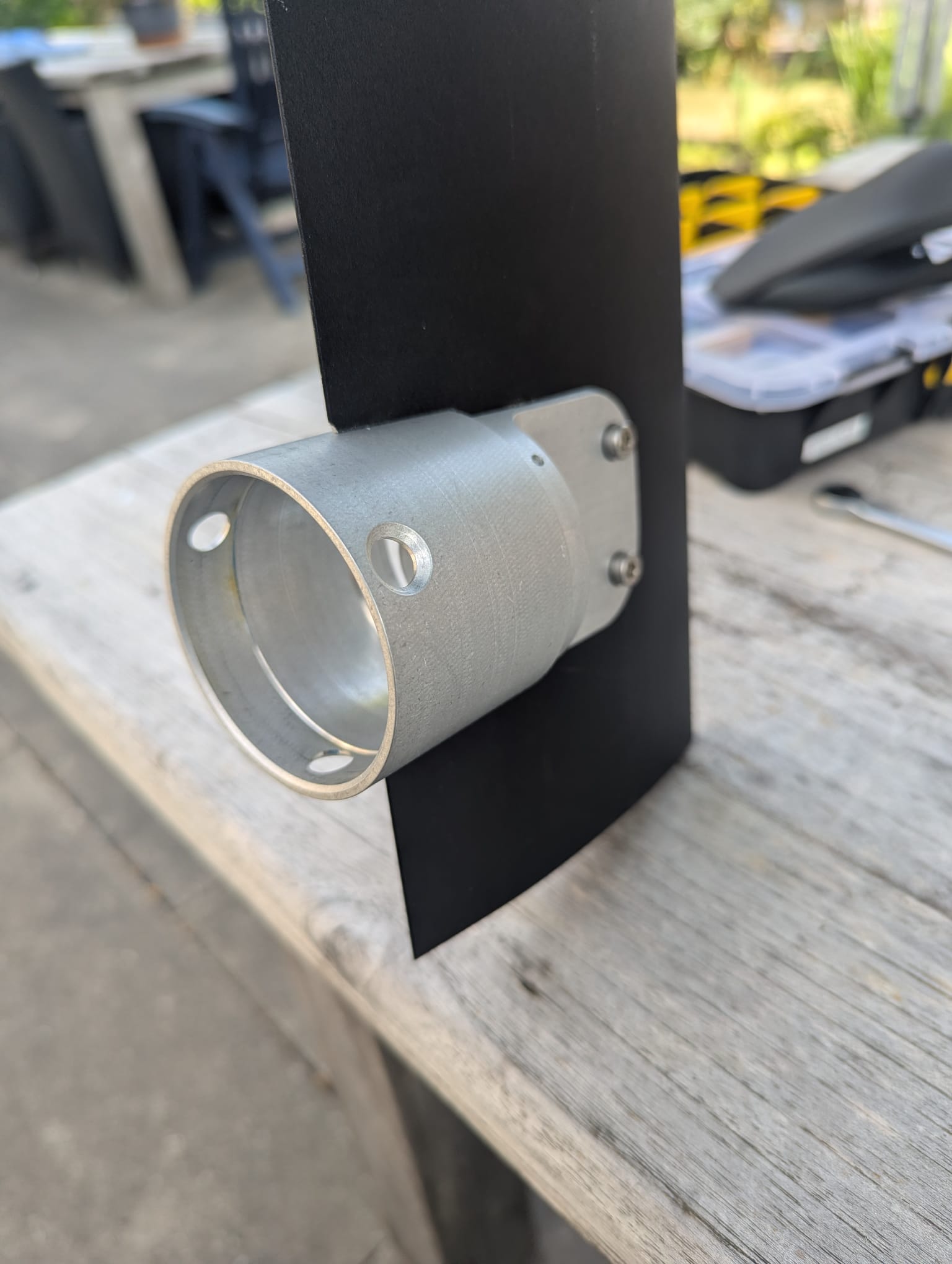

I just pulled the trigger on Fliteboard Pro and now planning to machine the adapter plate. Could you share some insights on this? Did you come up with some new better solutions :yum:

Most of the new all in one plates we had made are for the new Gong V3 mast (17 mm version), but we also had three plates made for the V2 mast (by request).
The new Flipsky 75200 PRO(?) VESCs have four small lips on the PCB (where the screws hold the PCB to the bottom casing). You may need to take this into account and update your CAD, or just use a file and remove the lips from the PCB.

Besides checking the mast fit after every tool pass, not really… just go for it.
