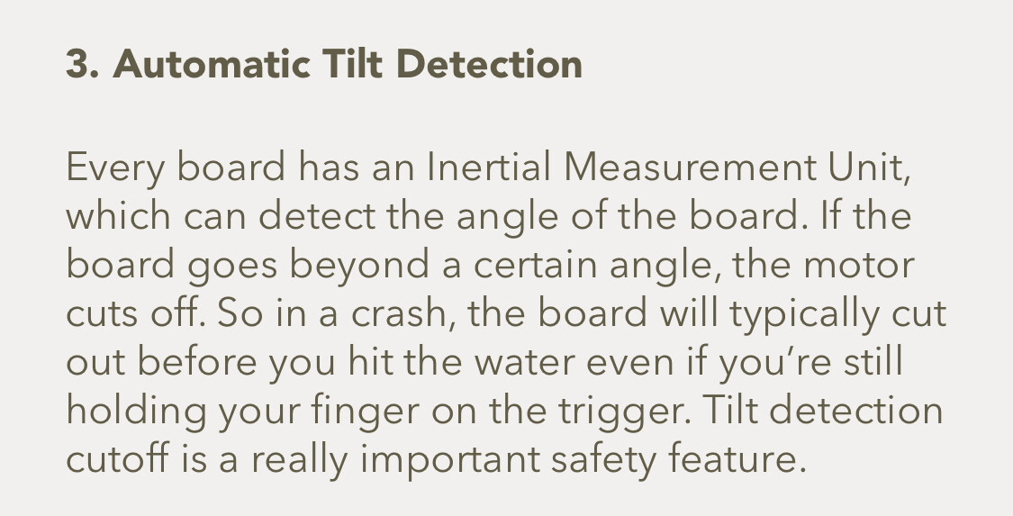

This is what is posted on the Fliteboard site about their method.
Lift indicates the board does “auto-shutoff” when the controller hits the water. Not sure what that means.
