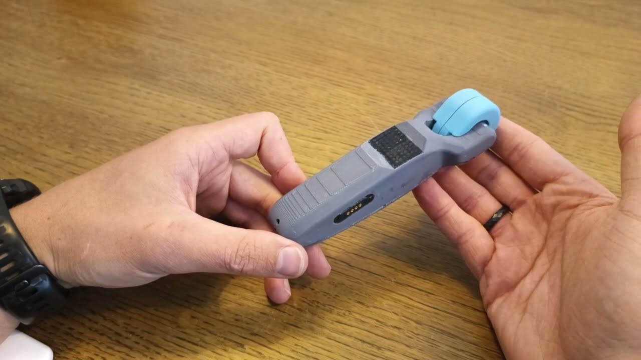

V2 Nano Update
Hey everybody,
You may remember the BREmote V2 Nano, that was originally designed with 10 LEDs. While that idea made the cost and complexity lower, it increased assembly difficulty and reduced readability of data.
I have changed the design of the Nano to also feature the full display like the “big” V2.
Here is the updated tutorial:
openfoil is preparing the sale of the new kit and will keep you updated separately.

Hi Ludwig,
Any idea on when the Nano will be released? My VX3 Pro is currently dying and I’ll need a replacement quite soon… Thx
You’re not the only one waiting for it.
Empty housing is waiting:
As far as I know, it should be available again in the shop very soon.
Just a matter of days? #pray
Hey, check the information here: LINK
Ordered, Thanks ! Could you please confirm the “Big” Led display is included as we can’t really tell from the pictures nor from the description…
Can’t wait :laughing:
Jasmin wrote it’s included
Indeed . My bad… too much in a hurry
